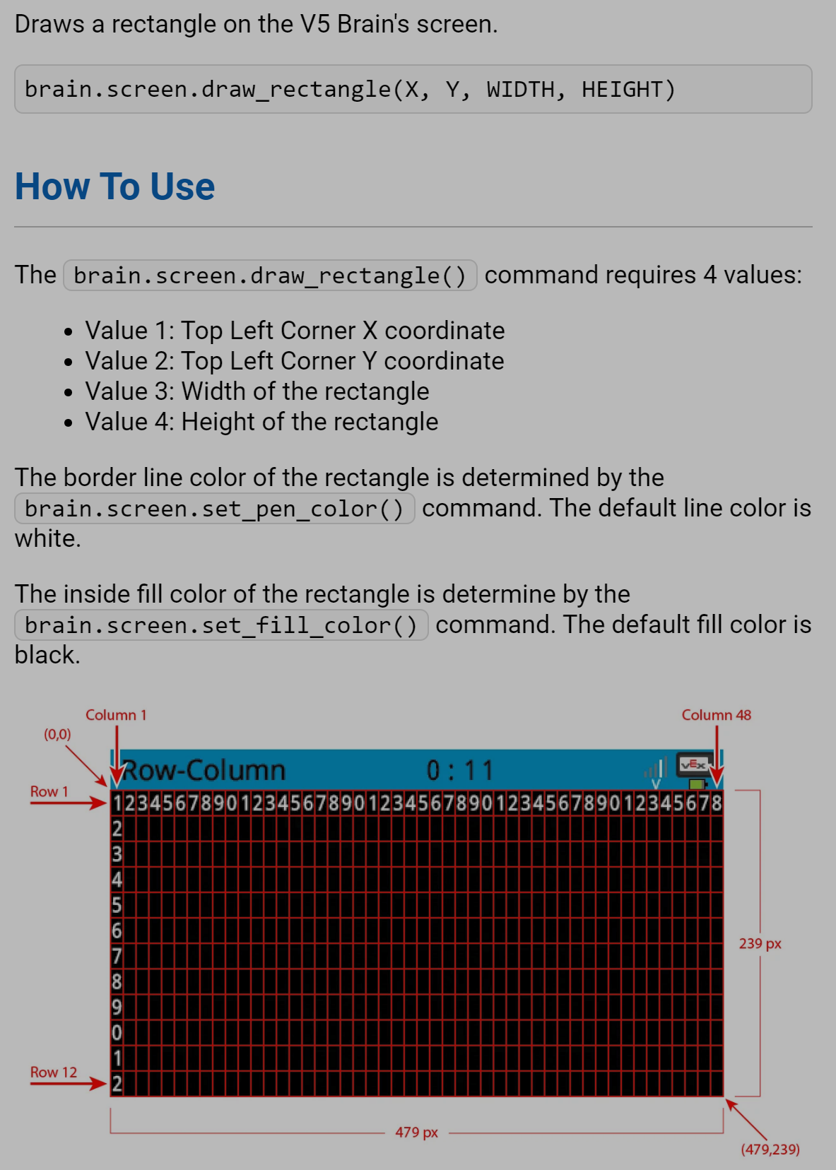

2: struggling with getting my rectangles to actually fit on the screen where they are all the same size. (print rectangle (x,x,x,x)
3: what does set cursor do? and what can it be used for

  2. For the rectangle, using the same number for all 4 parameters in the bracket won’t necesssarily work.
    If you want a square, just equate the last 2 and use the first 2 parameters to control the position.
  3. As you can see in the image below, the screen is broken up into pixels and when you are printing to the screen (writing text onto the screen), there has to be a starting point, hence the set cursor function, which sets the pixel to start the text from.
