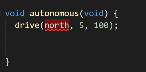

For some odd reason, now it says that forward is a vex::direction type. I then changed it to north but now it keeps saying that north is undeclared?
code snippet 1 code snippet 2 code snippet 3
The first code snippet is from a file called autonFunctions.cpp, the second snippet is from a file called autonFunctions.h, the third one is from main.cpp. I included autonFunctions.h in vex.h and the syntax for creating separate files for custom functions has worked in the past. Idk why it doesn’t work now.
Not near a compiler, but you have made an enumeration class, so I think you’ll need to say
drive( direction::north, …
to let the compiler know that it’s a class.
That makes sense. I thought I could just write it rather than putting the class in. It works now. Thank you all for all of the help that you guys have given me.
