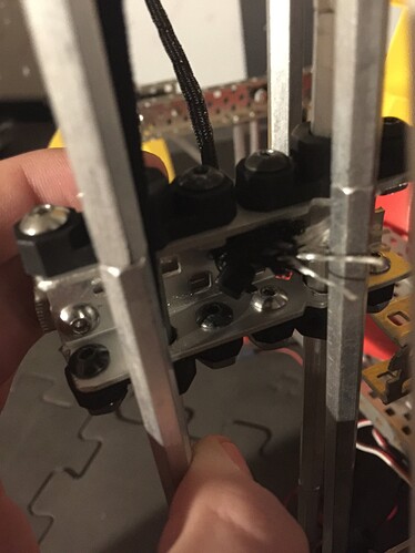

Maybe its time more people see this. First a disclaimer, i did not create this concept it was originally thought of from Steven (aka Stevo) from 7700R in ITZ.
What was figured out is that standoffs fit very nicely inside high strength bearing blocks and have a pretty low amount of tolerance allowing light low friction sliders to be possible. Using this idea i tried to create a cascade lift, here is a video of it in action:
and here are some pictures of the parts used to make this:

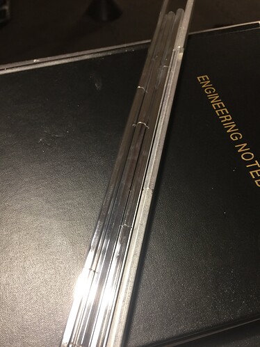

Something that i did while building this to reduce friction was polish the standoffs (sand them down with higher and higher grit sandpaper then rubbing them down with aluminum polish bought at a local Ace hardware). It was pretty shocking the effect that it had on the friction and how much dirt/debris is actually on standoffs. Here is a picture of polished standoffs beside a normal standoff.
Hope this idea can be used for something else that is cool (maybe a extending sleeve for the cubes), the elevator never saw competition because after 2 stages it became increasingly more ‘twisty’ and couldn’t handle the forces of a translational cone mover.
Side note: the way that multiple standoffs were assembled without damage was by using 2 nut drivers the size of the standoffs and very carefully tightening them with loctite.

You can reinforce the standoffs with shaft lock bar in-between the connection points.
The elevator wont work if you do that…
Why not? (post must be at least 20 characters)
wow that’s really cool! I’m actually going to use this type of slide now on my bot for something special (not a lift).
how would the bearings slide over the standoffs if there was a lock bar attached?
