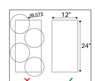

The intent of the area/thickness constraints is to limit the number of custom plastic parts used in
Robot construction, not to define an absolute volume. For example, using a sheet which is 0.035”
thick does not permit two 12” x 24” sheets’ worth of parts.

It would be illegal due to part b. All parts have to nest into a 12 x 24 area. There is no height attached to that part of the rule, so two sheets cut from 1 would be illegal
You came up with an important notion to test, but it turns out that you can’t do it. This is one of those circumstances where you have to read the material a few more times. R18 a) uses that exact example as something you can’t do. When you had that thought about a thinner sheet after reading though, ideally you would have checked to see if that thought is covered in the text. R18 b) explains that you have to be able to nest the parts in a notional sheet and continues to be specific about area available in that nesting, which is again the single sheet’s-worth. The italics note at the end it says ‘all individual plastic pieces must be able to theoretically “nest” or rearrange into a 12” x 24” area’, which pretty much nails it. It does seem like it could be put more succinctly overall, but that’s a living document maintained by a group under time constraints. This is good reading practice. You have to create and test foundations in your mind to support building comprehension of the message - for example, imagining contraditions like a thin sheet and then going back to the text. That usually takes a few passes when it’s technical stuff that’s new to you.

But only if you are allowed to stack parts on top of parts to fit within the 12x24 requirement. If stacking to achieve the area were allowed, the (4) 9.5" circles in figure 35 would be allowed as well.

No, R18a confirms the point that they are illegal as they were not cut from the same sheet according to the figure description.
