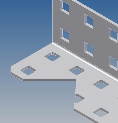

Cutting parts in Inventor does involve extruding a sketch. Here is one way to cut a shape into a part:[LIST=1]
*]Open part and save under a new name (i.e. “Cut_part.ipt”)
*]Create sketch on the face of the part you want to cut.
See attachments “Select Face.jpg” and “Draw.jpg”.

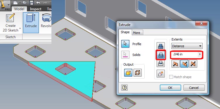

*]Finish the sketch
*]Extrude the sketch (the “Extrude” tool is found under the Model tab in the “Create” group)
*]In the extrusion, please note that the distance parameter should equal the width of the piece you are cutting. (for VEX metal, this is 0.046") Also, you need to select the option that makes the extrusion “cut” the part, otherwise you will get an error.
See attachment “Extrude.jpg”.

5.In the extrusion, please note that the distance parameter should equal the width of the piece you are cutting. (for VEX metal, this is 0.046") Also, you need to select the option that makes the extrusion “cut” the part, otherwise you will get an error.
In this step he said it has to equal the width for a cut away extrusion when it in fact doesn’t. You can put in a number ranging from anything above 0 to something ridiculously high. If you want to cut all the way through you could just put a distance that you know will cut all the way through like 1 inch or so that way you don’t have to know every little precise distance. On the other hand if you want to cut a depression or hole into the surface you would enter in something less than the width (something precise).

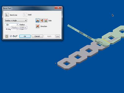

Using the bend tool.
Open the part (or better a copy of it)

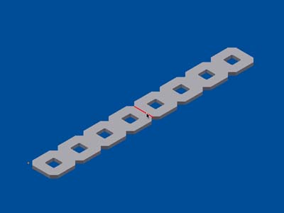

Crteate a 2D sketch on the part surface and draw a line at the bend position
https://vexforum.com/attachment.php?attachmentid=4582&stc=1&d=1318534420

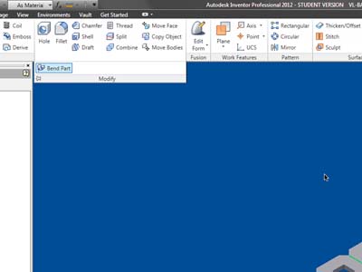

Open the Bend Part tool from the modify menu
https://vexforum.com/attachment.php?attachmentid=4585&stc=1&d=1318534427
Select the sketch line you just drew, adjust the parameters
https://vexforum.com/attachment.php?attachmentid=4588&stc=1&d=1318534434

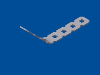

Done
https://vexforum.com/attachment.php?attachmentid=4591&stc=1&d=1318534440
