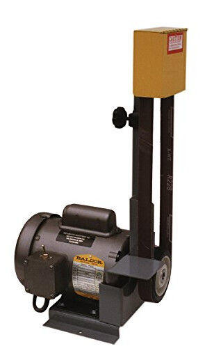

That said, we use a bandsaw and benchtop belt sander. The sanding is the critical part of that process.
It’s sort of an investment, but it’s versatile and FAST for sanding:
shafts
cut metal
plastics
etc
