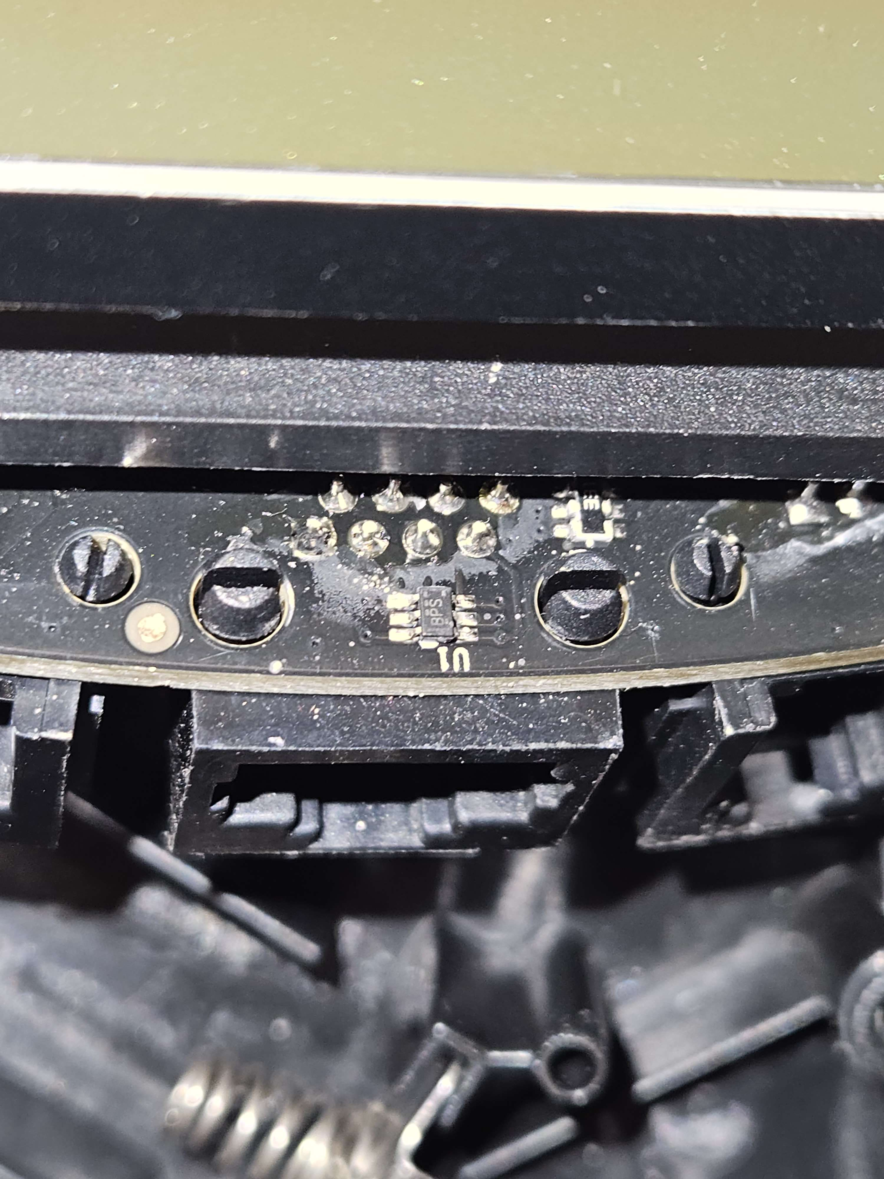

I recently mistakenly plugged in a smart port into the legacy field control port on my v5 controller and has made the controller impractical for competition use since it is unable to run autonomous and a few other things so I took the controller apart to see what was wrong and I found a cooked chip
I was wondering if someone could attempt to identify this chip and let me know what chip I could buy to unsolder and solder on a new one to use as a non competition controller we can use as a dedicated skills test controller or something at school
This is what the chip should look like
This is what my controller’s looks like

You could take a chance that standalone operation is normally open… and just remove the chip and see if it runs.
You were correct I removed the U1 chip and it is now out of competition mode thank you
I am still wondering what the function of the chip was to possibly replace it someday just to have it
For now though this works I’ll update if I find any hiccups but I likely won’t thank you again
It’s a quad TVS diode protecting the competition control lines and controller from static. Best thing would be to find a RJ45 dust cover and block the port.
