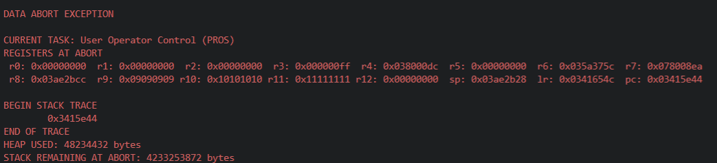

Does anyone understand this and know how to fix it:

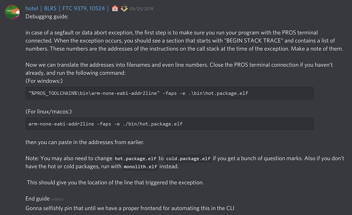

Also I have looked at other forums and from what I have gathered, this is also needed to solve the problem:

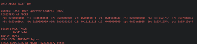

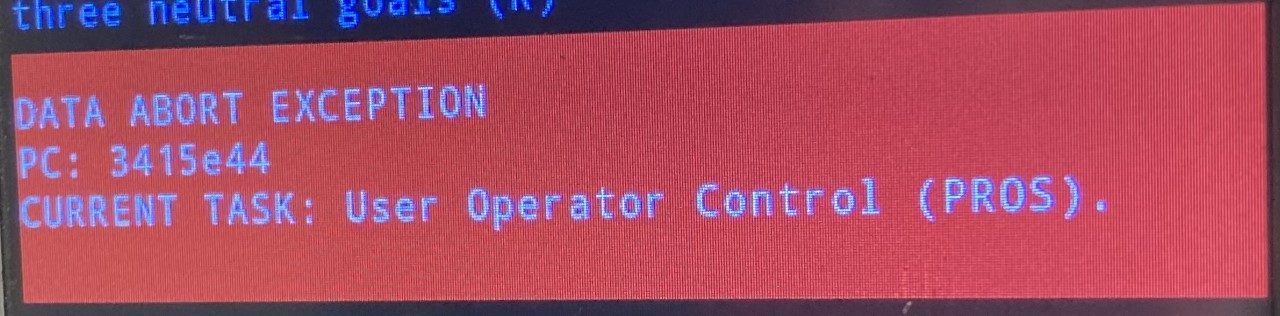

You have a bad pointer or something like that and are crashing the V5 processor.
simplify your code until you find the offending function.

How do I run the command?
Can you send your code? I think you’re using an incorrect data type that isn’t showing up as an error before run time. Plus I see that the heap had A LOT on it, so maybe thst has something to Do with it.
sorry never mind, I ended up just restarting pros on my computer and everything was fixed.
