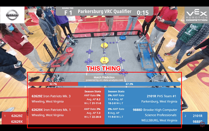

Here’s something we’ve been playing with in our event livestreams over the last few weeks – a display to show some additional info before each match starts:
The original goal was just to show the name and location of each team before the match started, as TM will show this info on the non-overlay match intro but won’t show it if you’re using the overlay display. But after a few weeks’ worth of feature creep, it now does some additional stuff:
  • Optionally show some season-long team stats, which are pulled from the RobotEvents API and updated every few minutes.
  • Optionally hide the country from each team’s location (to save space, since at most events all teams are from the same country)
  • For VRC events only, optionally show the predicted match outcome as forecast by vrc-data-analysis.com.

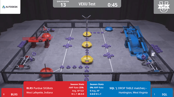

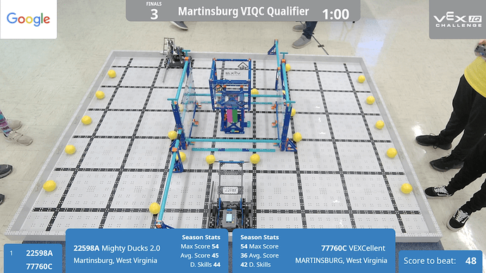

VIQC, VEX U, and RADC events are also supported, here are some screenshots of what those look like:
More screenshots
The display itself is just a web page, loaded as a “browser source” in OBS. There is a small companion app which interfaces with TM and tells the display when a match is started or queued. The display will hide itself when a match is started and reappear when the next match is queued, so the whole thing works pretty seamlessly.

EPs should not be perceived as projecting outcomes for matches.

if it showed stats for the teams at the event for the event only, that’d be pretty cool. showing stats from all competitions and having a prediction bar is where it could get confusing to spectators that don’t know much about vex competitions (ie. a team with poor season stats has done a redesign that works well, and is doing well at the competition but because of their season stats they have a low prediction percentage).
concept is sick, i just dont think its showing the right stats

Yeah, this is definitely a concern I have had as well. Showing the match predictions on stream was something I wasn’t sure about the first week we tried it, but it got a pretty positive response from several teams (we also show the stream on a big projection screen in the venue) and so we’ve kept it around for now. Additionally:
  1. I think the prediction being tagged as “powered by vrc-data-analysis.com” makes it at least somewhat clear that the prediction is coming from that website rather than the EP.
  2. Anecdotally, teams “beat the odds” all the time, including the red alliance in that screenshot above.
So all in all, I don’t think this is creating a perception that we have a preference over who wins each match.
(and also, the predictions are optional and off by default)
