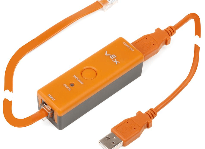

Is it possible to store information on a cortex other than a program? I want to be able to store encoder information, time, and motor control value. If I can’t store it on the cortex, is there a way that I can transmit it to the computer that I’m using to program it?
Regarding the storage of information in the cortex I am unsure. However, for the transmitting of values from the robot to the computer you may want to try opening the sensors debugger window in robot c while your computer is connected to the robot via a USB cable, this will give you ‘live’ values of your encoder values. Hope this helps.
If you are using robot C 3 or 4 you can write to the debug stream. If you are using 4 you can also graph you data.
How do I do that while I’m driving the robot?

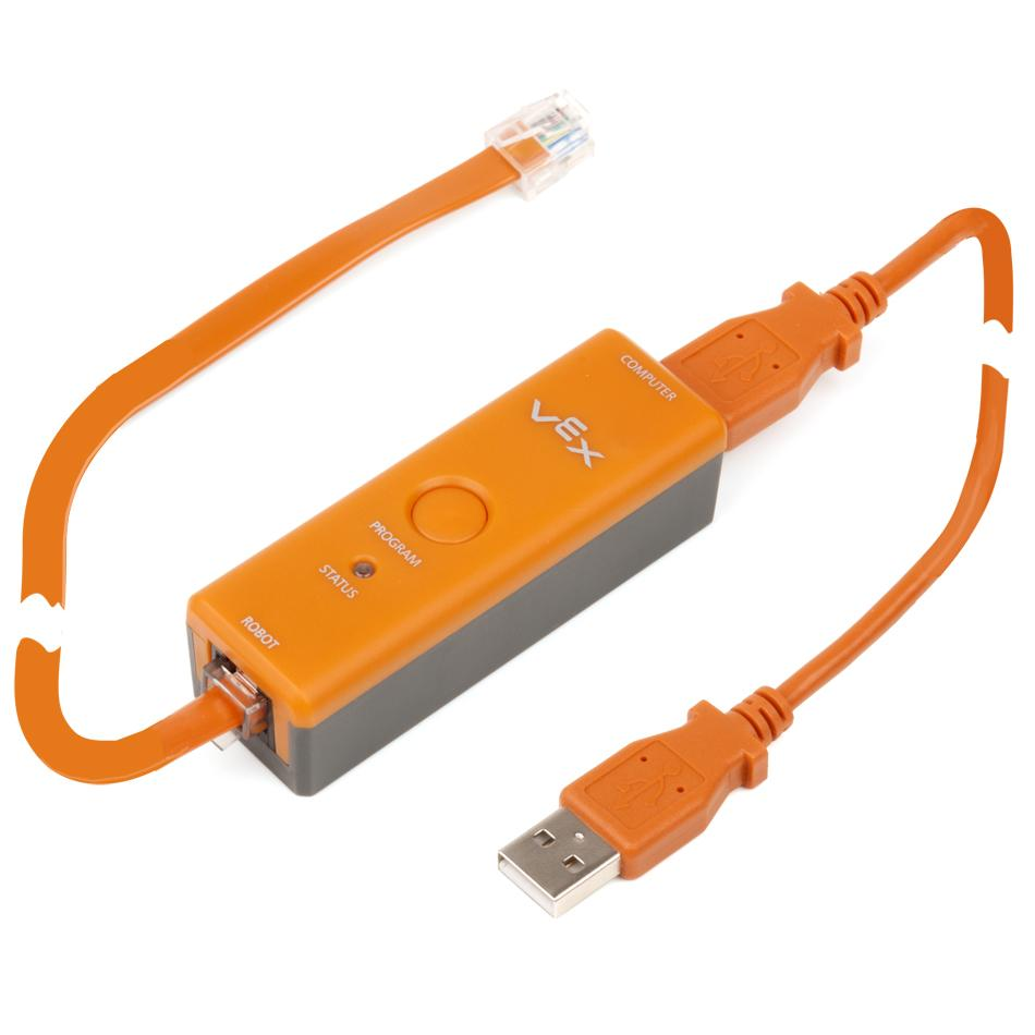

If you have a wireless programming cable like the image attached you plug that into your controller and computer. then upload to via (F5) (still wireless). you can then go to robot > debugger windows > Sensors and it will show you sensor values. you could also use wirteDebugStreamLine(); to print data to the debug steam which can be opened by robot > debugger windows > debug Stream. you can look here for graphing. Make sure you hit start to enable you to drive and read values.
