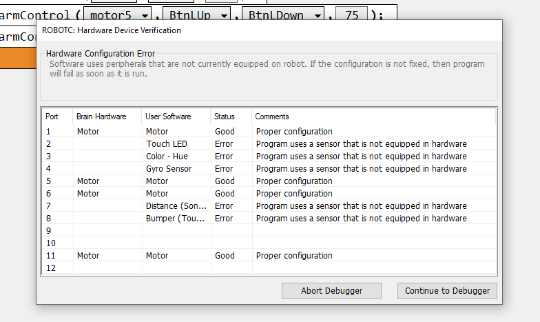

Hi, this year our programming software is Vex IQ Graphical. We are completely new to programming so we have been making a small program but when downloading to robot a pop-up box telling us either to debug or abort debug. After we tried checking the vex utility but the computer did not detect anything. Although the computer said there was an unrecognized device in the bottom right corner of the screen.

Can you post a screenshot of the particular behavior you describe?

Here’s the screenshot you requested ⁠—when we click either of debugger options below, the message pops up again.

Ah, well, that appears to be telling you pretty clearly what’s wrong - looks like you’ve configured several sensors in your program that aren’t physically connected to the robot.
Do all the sensors you set up in the program appear to be physically connected to the correct ports on your brain?
Oh, that makes sense! Thanks for help! We must’ve set the code to include sensors that weren’t hooked up to the bot just yet.
