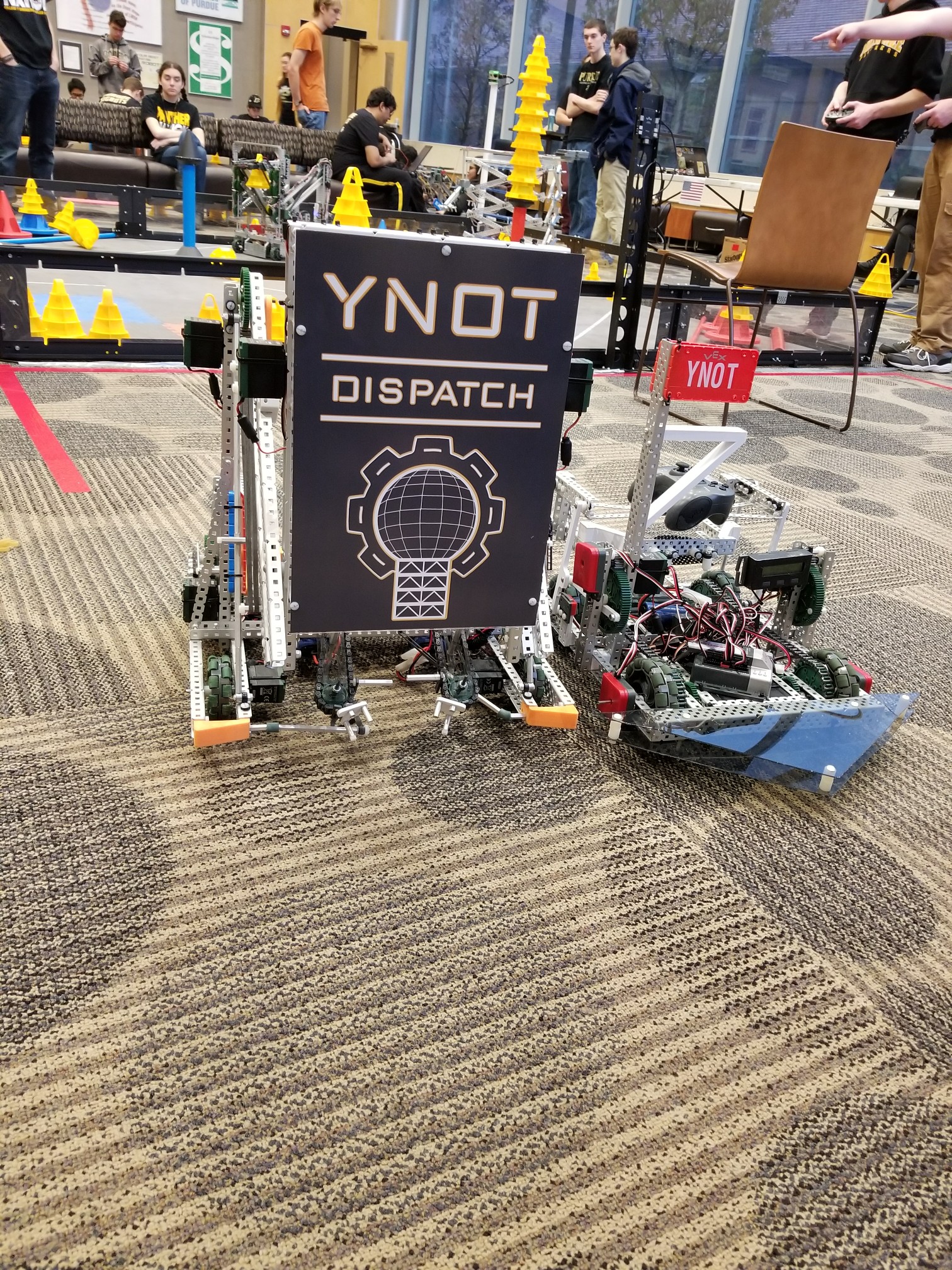

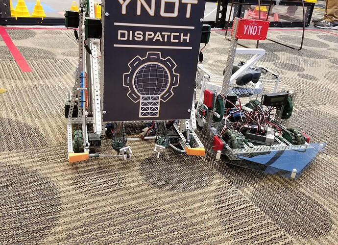

We use a vinyl cutter and when necessary put paper behind the plexi. Wish we had a laser engraver… maybe next year.

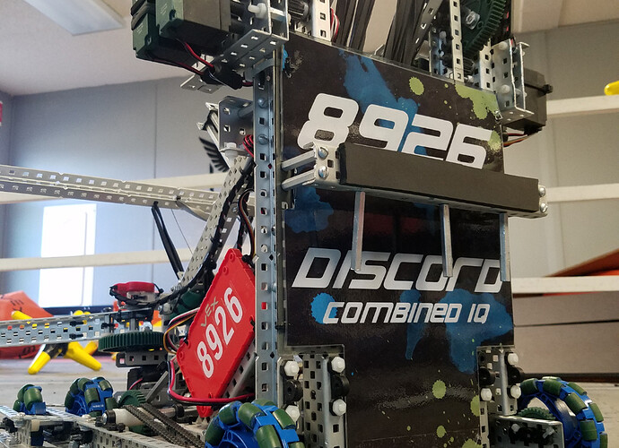

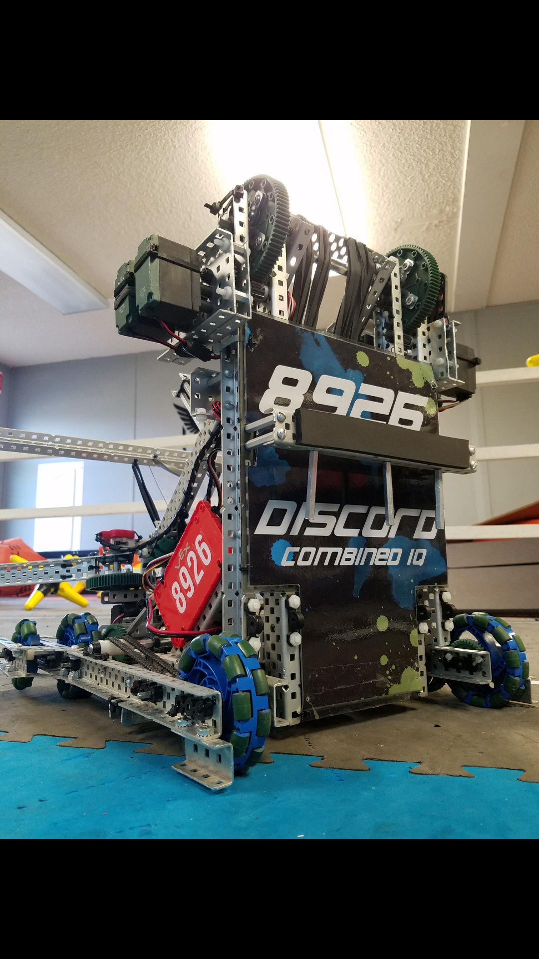

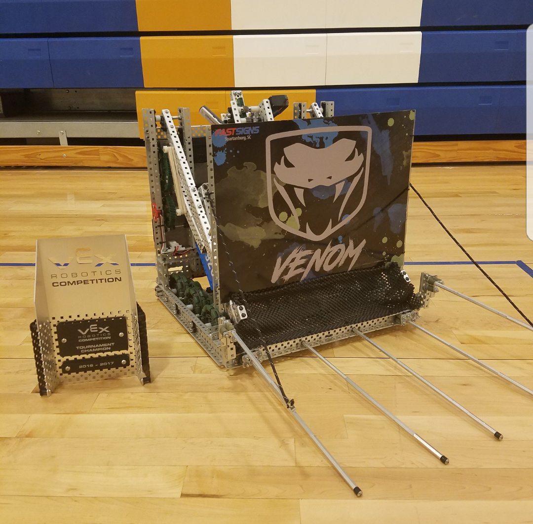

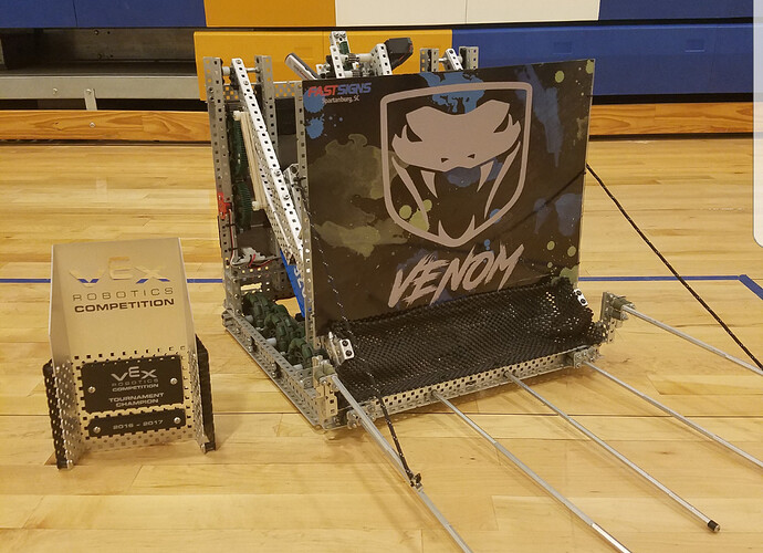

I have fallen in love with decorating my polycarb. I prefer to make vinyl decals that I get printed from my local FASTSIGNS store. Here are some examples of their vinyl quality.

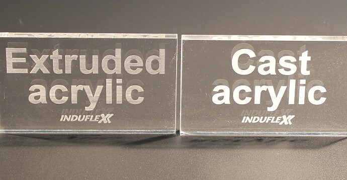

for clear plexi laser engraving is difficult if not prepped right. Just depends on the brand of laser engraver. We use our vinyl cutter to make our graphic stickers for our robot.
Plexiglass (acrylic) is actually very easy to engrave compared to Lexan (polycarbonate.) Unfortunately, you’re not allowed to use acrylic on a competition VEX robot.
There is a difference in how extruded versus cast acrylic engraves. This photo tells the story pretty well:
The image is from this website:
http://www.pmma.dk/acryl_stobt_kontra_ekstruderet.aspx?Lang=en-GB
