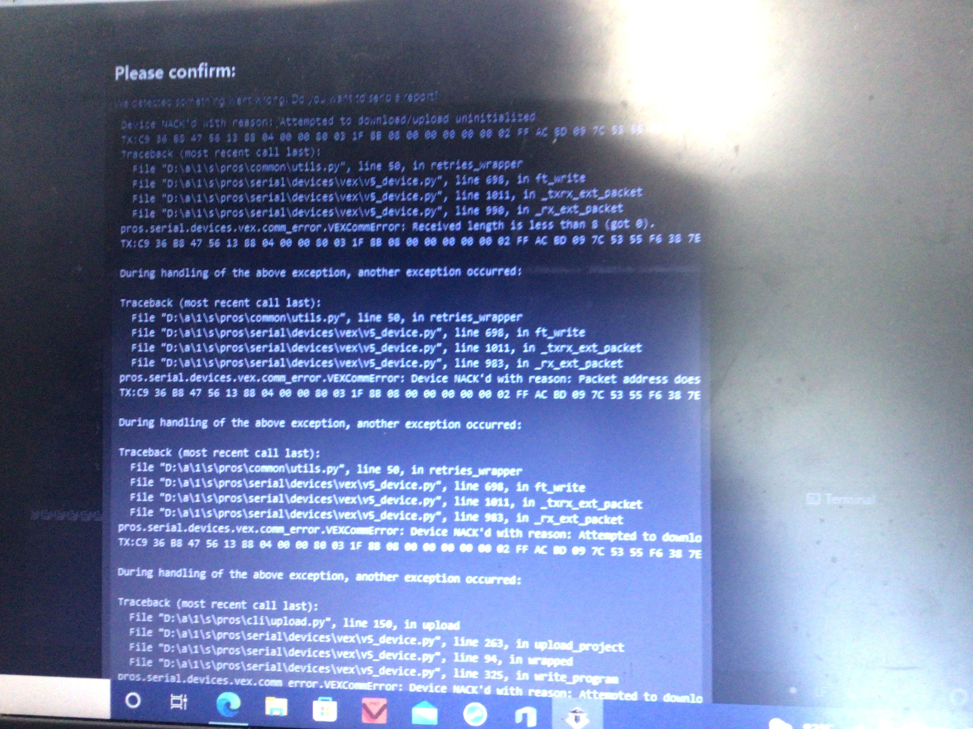

This is quite strange. I opened up a new project in pros, clicked the quick action button, and then I get this:
Sorry, laptops wifi is broken so I can’t ss it. I’m not even allowed to exit that screen, I have to restart the app,but I’ll get to that problem later. How do I fix this error? I literally hadn’t touched the code.

Based on my experience of programming rather than PROs that is caused by using a value the function does not understand. So it looks like something is in your code where a value is incorrect (but still formatted correctly). This means the various VEX libraries now are having errors trying to process this dodgy value.
So you might have accidentally typed in a random character where it shouldn’t have been. The top of the error message (which doesn’t seem to be in the screenshot) should list the line in your program with the dodgy value.

you need to provide the full output when you try an upload, forget Atom, use the command line and paste the full output here in code tags, the screen shot is not useful as it’s showing errors after whatever was the initial reason for failure. Make sure all other programs that may try and communicate with the V5 are closed (VEXcode etc.)
