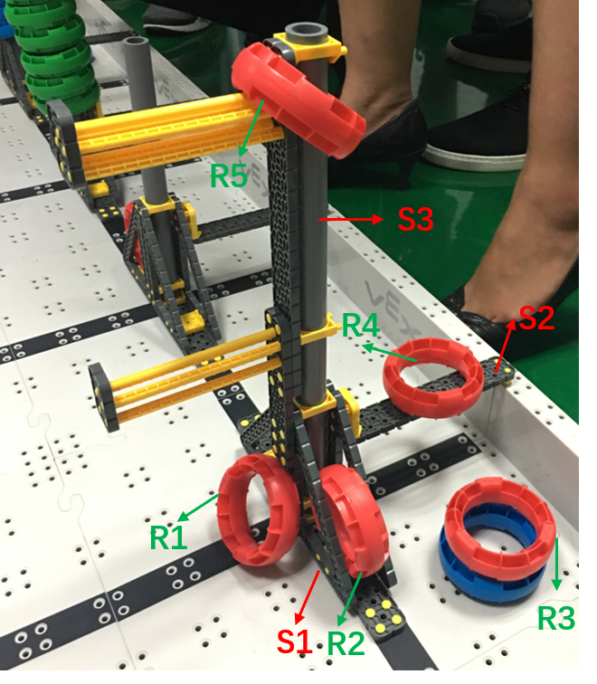

Hi all,
See the attached pic.

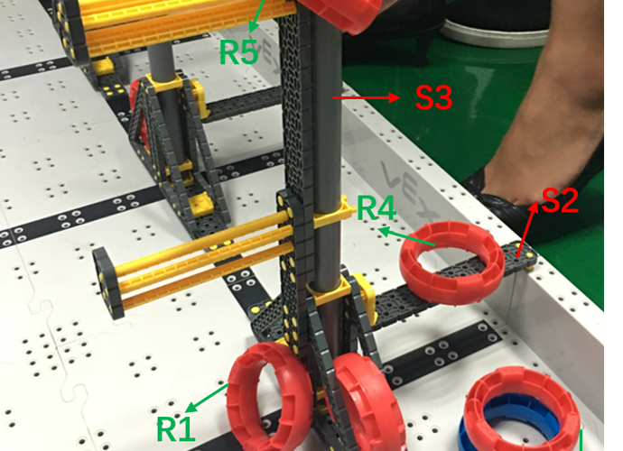

Will the structure of Horizontal Post include S2(the beam connected to the field perimeter) and S3(the PVC pipe and the IQ pieces)? If yes, will the ring R5, R4 be considered as scored? Because the definition of Floor Goal says “The black line and the support structures of the Posts are part of the Floor Goal”.
According to the definition above, will R1, R2 be considered as scored? Because the two rings are touching the support structures.
