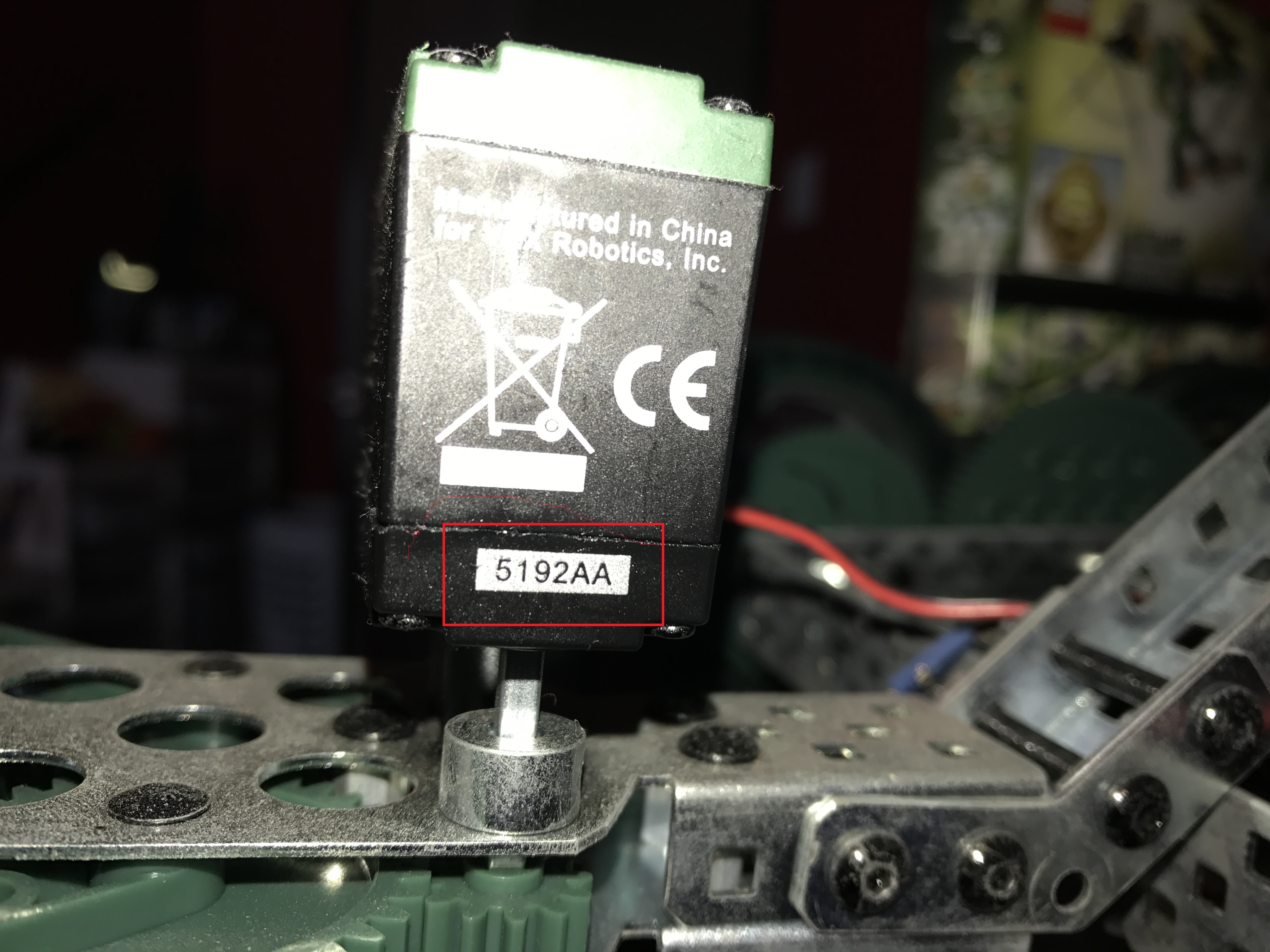

At the beginning 3 qualifying matches, we were undefeated and demolished the enemy teams. But afterwards, every other match our motors on our lift locked up on us, which made us lose. We then went down to 30th place(or something like that) and we were never picked because we were considered unreliable. But luckily, we were able to get design awards, which allows us to go to worlds. This wasn’t just me who was having the issue, almost more than half of the 400’s were too. My suggestion to EVERYONE, is to NEVER BUY a motor with a serial number of 6000 or higher. They burn out really quick and they are extremely unreliable in-game. It is best to buy motors with a serial number between 5000-5999 because those types burn out much less, and are just as good at performance. VEX, can you please fix this burnout issue with the motors?

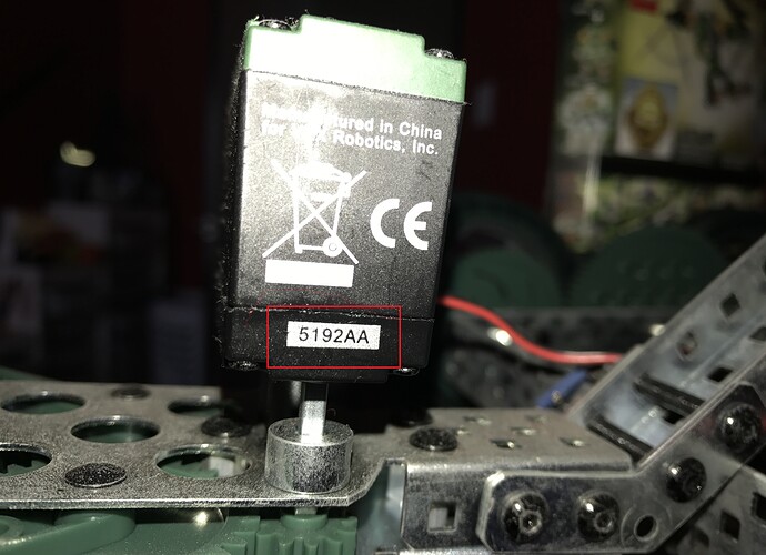

The serial number is found boxed in on this picture of a clawbot, which shows a motor which I consider good:
What defect in the motor do you think causes the extra burning out?

Yeah, the 6000-6999 motors definitely run smoother than the 5000-5999 motors. But the main issue is that they lock up extremely fast after only mild use over time. I think this is happening to some of the 6000-6999 motors, but just to make sure, I recommend 5000-5999 type motors. My claw is currently using 6000-6999 motors, and they lock up extremely fast, so I divided the motor power by an amount of 13 to make sure they don’t have the issue that frequent, but yet they still lock up over time.
Good thing, I had a clawbot at home with barely used motors that are in the range of 5100-5200. So I will most probably be putting those motors on my robot.
