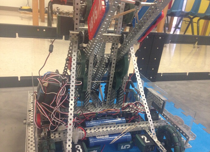

As expected, looking good. How much have you had to replace due to broken parts from your catapult?
Absolutely 0 parts were broken and our catapult worked 1st try!
What about after the 1st try? Have you tested it more than once?
Yes we have. We were in a rush so didn’t have time to practice or add more things… But I shot it a ton of times before competition to find the “Hot Spot” and I figured that the hot spot is about 10 rubber bands. We will be adding more motors to the catapult though to shoot a mass of stars and cubes.
Adding or moving? What’s your motor distribution?
I will be adding more motors and I might have gear ratio with more torque. We can shoot 1/second but it seems better to be stronger and shoot larger amounts… We currently have 4 motors(two on both sides) that are on a 36/60 gear ratio to a 36 slip gear, which the slip gear is slipping an 80 tooth gear. So in total our ratio is (36/60)/(36/80).
What about the distribution of motors.
We currently have 4 motor “4 wheel drive with a 2 motor 2” strafing wheels, 4 motor catapult, and a 2 motor lift assist that doubles up as a mechanism to hold the catapult in the down position. It is very complicated but it seems to get the job done :stuck_out_tongue:
I believe you mean 84 tooth gear. There’s a 12 tooth metal pinion, 36 tooth gear, 60 tooth gear, and 84 tooth gear.
What’s your base internals
Oh sorry my bad. I am on my phone so I can’t really look it up…
Our base basically is an H Drive wth two 2" strafing wheels hidden inside of the frame. The drivetrain has 4 motors with 4" wheels with chains for the front two wheels to add a little bit more space for the lift system. It has 3 encoders (1 for front-back movement and 2 for strafing movement), and the batteries have a very snug compartment below the catapult mechanism to improve space reliability. Our drive it self contains 300 lines of code to create this type of driving that that we call “Gyrodirectional Movement Arcade Mode”. Basically depending on the direction of the robot adjacent to the fence is the direction the joystick will go. For example, if the robot is facing the fence and you are at the side driver zone, if you tell the robot to go forward, the robot will strafe. But if the robot is turned 90 degrees left and told to go forward, the robot will go forward. Hopefully that answers your question :slight_smile:
no, i mean what are the internals on your motors like torque speed turbo etc? thats really cool and id love to learn more about what you mean, but i just want to know the internal gearing of your motors. @CATaclysm Delta_II
Oh sorry my bad. The motors for the drive are all high speed. I may try turbo in the near future though…
thanks, we have 4x turbo and it works like beauty
You’re welcome :slight_smile: I think I might try it once thanksgiving break ends.
