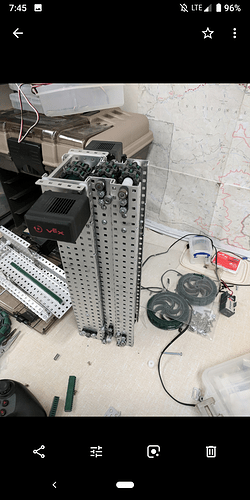

But I built a working cascade lift that can actually cascade and score caps. We also have a passive puncher and a 6 point auton
This Cascade lift is the most compact I’ve seen, u like the drive, it’s my first bot this seasonScreenshot_20190313-081945Screenshot_20190308-074553
