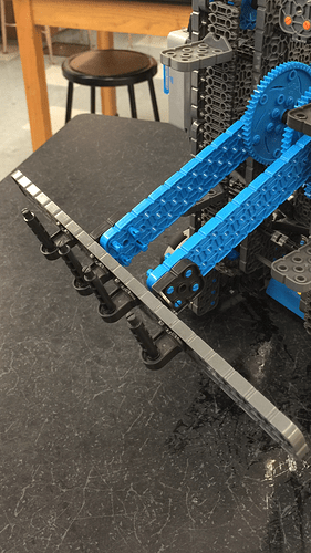

There are multiple designs that can get the green cube onto the high platform and not go over the 15" height limit. Even picking up the cubes from the top and without being motorized like a claw. Here’s an example from the sister team to my daughter’s team What is better, Stretch or Flex for VEX IQ Squared away? - #24 by spaghetti_code.
Basically, a simple rotating arm… not a 4 bar or parallel bar… just a simple rotating arm will do it. My daughter’s team and my son’s team all have passive mechanisms on simple rotating arms on their robots.
This can reach the high platform although at a slanted way. I believe this is a simple rotating arm
