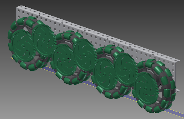

I want to see some eight wheel drives using 4" wheels this year -
Give me the parts and I won’t think twice of why I did it.
That’s exactly what we are planning for our first try except we will use 4 omni and 4 mecanum since there’s no sacks to get stuck on and the omni wheels will help overcome the slippage we got with mecanums alone.
Nice! It should be noted that the upper gears on what I posted do not line up with any of the existing hole patterns and you would need to drill your own holes for those. The more I think about it, chain + sprocket may be a much easier & modification-free way to do an 8WD. I think I also had something like less than a quarter of an inch of clearance on the 18" bounding box dimension, so not a lot of breathing room.
Our first design for our drive train had 10 wheels… but it caused way to much friction to actually power all of them.
Then you did something wrong.
Yeah we did. It was our first prototype of a two speed shiftier that was thrown together. We ended up ditching 10 wheels, as it wasn’t really necessary at all, and actually lined up the axles so they spun properly :wink:
The 8-wheel drive has one problem, hanging. That looks super heavy.
