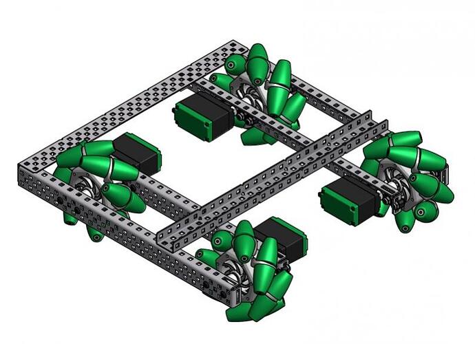

The drive is based around a standard 25x25 steel chassis. Aluminum could have been used but we have a number of these that came with classroom kits and were available. Version 1 of the drive constructed the chassis in the standard way, after testing it was decided to push the front wheels forward to create a larger wheel base and help keep the center of gravity behind the front axles, more on that later, this meant replacing the front angle with a C channel behind the wheels. Power for the drive comes from four 393 motors geared for torque directly driving the four mecanum wheels.

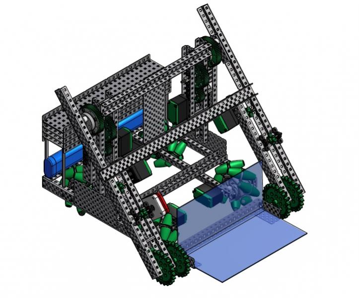

The three sub systems come together as follows.
[ATTACH]6911[/ATTACH]
[ATTACH]6913[/ATTACH]
The 1x5x1x25 C channel at the back is ballast needed to counteract the weight of the sacks.

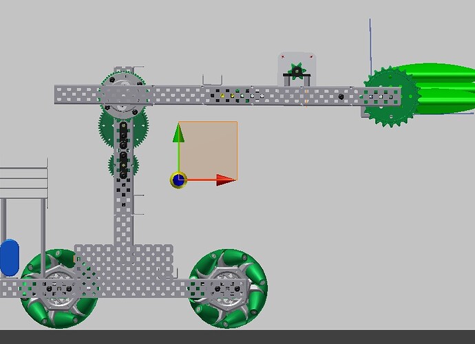

Before building we used the CAD to determine the estimated robot weight and center of gravity.
This shows COG with four sacks and the arm in the worst case position.
[ATTACH]6919[/ATTACH]
COG is still behind the front axle so the robot (when not accelerating/decelerating) should not tip.

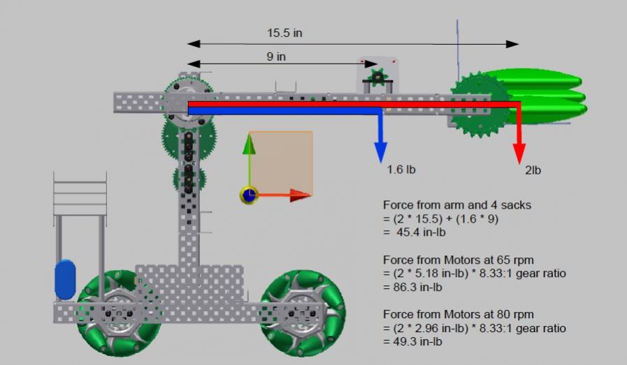

The CAD shows the weight of the arm as 1.6lb, this, along with the weight of 4 sacks, was used to calculate the force needed to raise the arm.
[ATTACH]6920[/ATTACH]
The robot can actually lift 10 sacks without problem, however, in competition it’s usually limited to 4 due to the current scoop design.

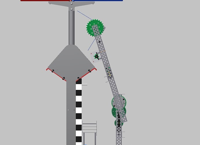

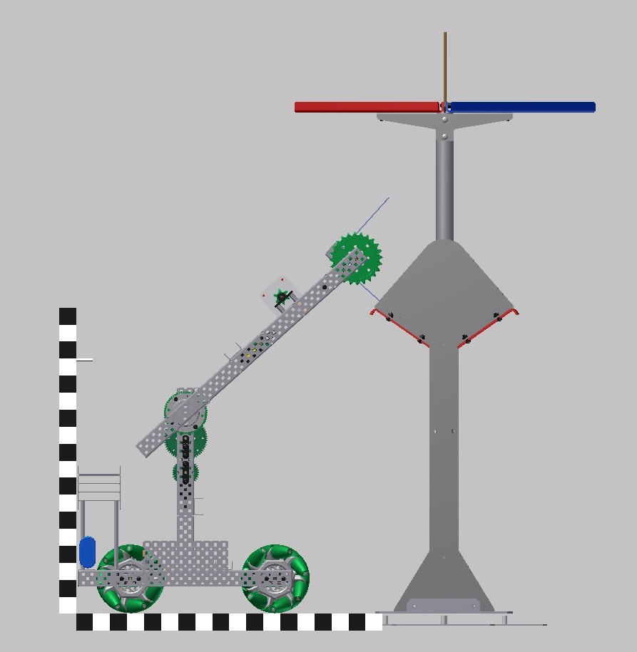

We also used CAD to check scoring geometry.
[ATTACH]6921[/ATTACH]
Also behind
[ATTACH]6922[/ATTACH]
