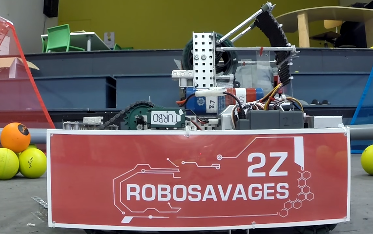

I was wondering how teams print designs on their Plexiglas.
Sharpies and a lot of time? Maybe some spray paint to speed up the process :wink:
I mean designs like this.

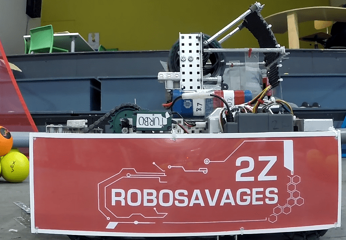

Probably just CNC vinyl, like from a Cricut machine or one of the other cutters. That’s how I would do it at least, really easy to cut mirrored and apply to the back side.
Is there an easier way, we don’t have access to a CNC machine in our high school.
Ok, what we do is we just print it out on a peice of paper, then tape it to the other side of the plexi, if you do it right no one can tell the difference
Oh wow, that is exactly what I was thinking, but I assumed there was a better way.

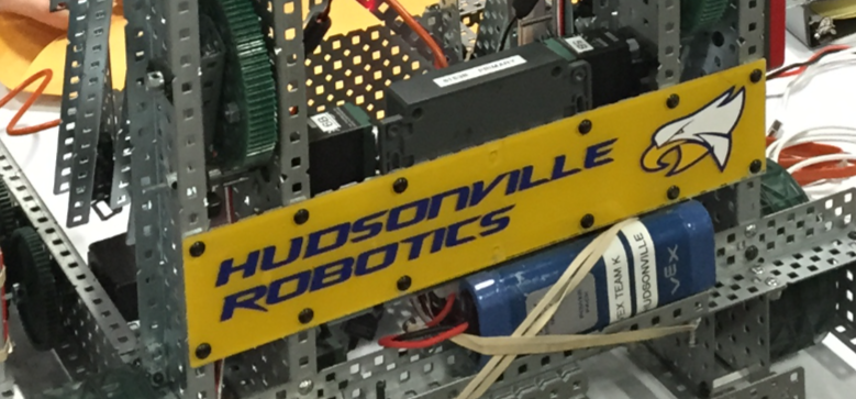

My wife has vinyl cutters for her business that I occasionally use with teams to cut their graphics. You can check with sign shops in your area - many have that capability. There are also Custom Vinyl Cutting services on the web. Some sites have an application online where you can design a 12"x 12" image for about $20. They will ship it to you on backing paper. You carefully place it on your clear plastic and press down. Just know that it is a one time application so plan carefully and take your time.
The image below shows clear plastic that we cut to match a Vex plate. The vinyl was printed backward, placed on the back of the plastic and sandwiched between the plastic and the plate.

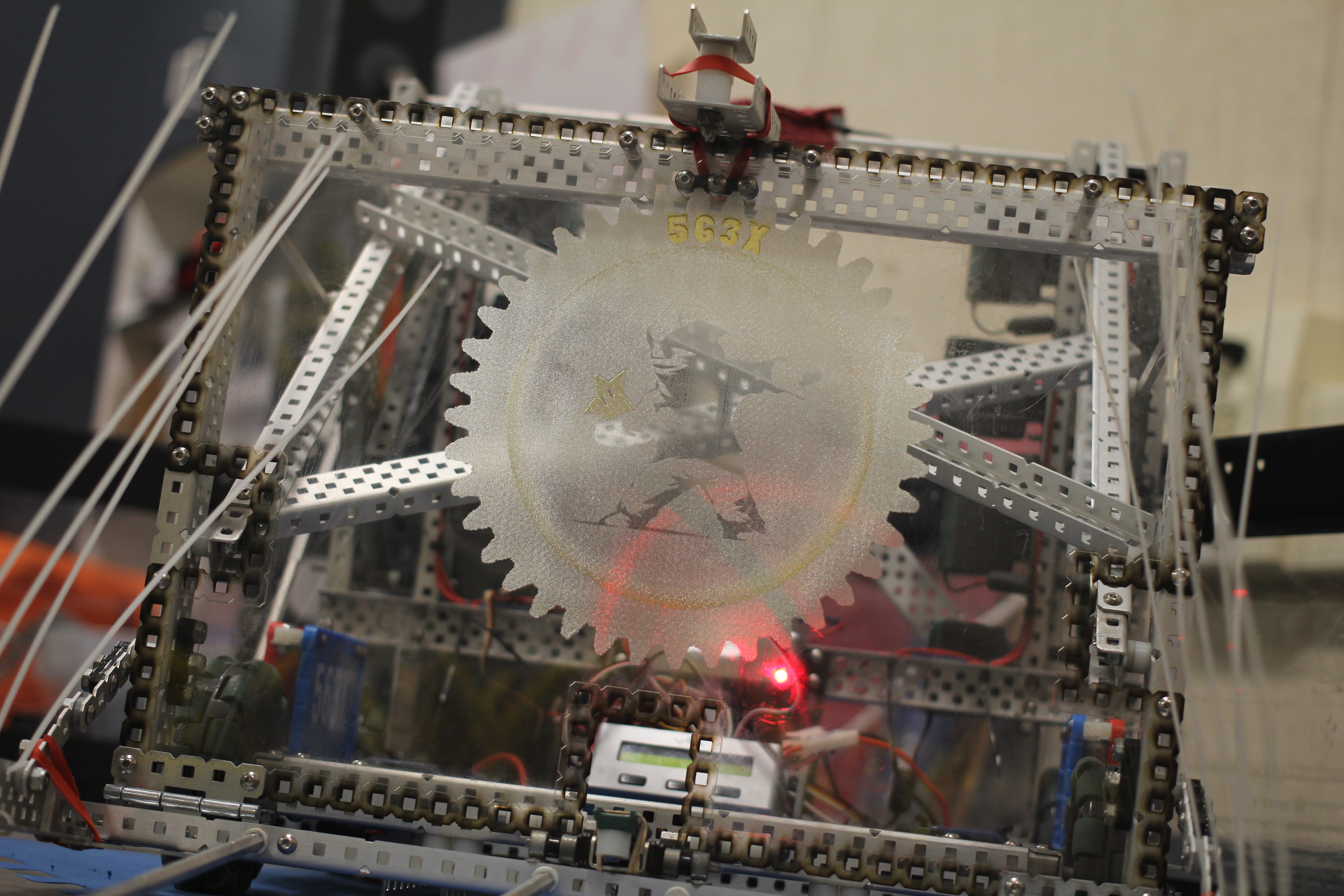

We laser engraved ours (563X) This picture is from the beginning of the season…
