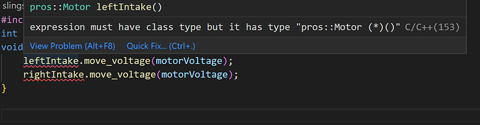

Should I define my devices in PROS individually in each function, or create a seperate header file to define my motors in?
Separate file, but declare them in a header file and define them in a source file.
If you are using the new keyword to construct the device you are doing it wrong.
