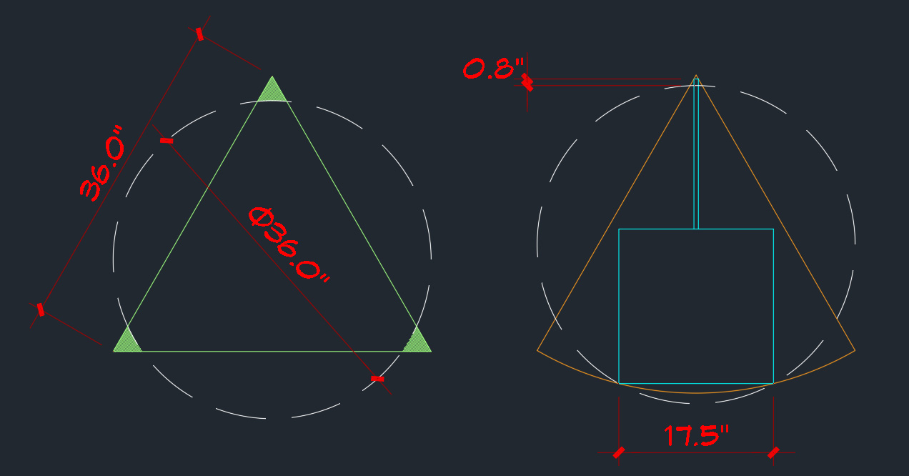

<SG2> b) Once the Match begins, Robots may expand, but no horizontal dimension can exceed 36” (914.4 mm) at any point during the Match.
In order to meet this rule, you would have to be able to draw a 36" circle on the ground and have no part of the bot extend beyond the circle. You would also have to be able to project that circle vertically perpendicular to the ground and still not intersect any part of the robot in any configuration (i.e. an arm moving in a vertical arc, etc.) The solid thus described is, my friends, a cylinder.
No, not quite.
Here is a quick example. Draw an equilateral triangle measuring 36" on a side. Draw a 36" diameter circle centered on the center of the triangle. Measure point-to-point anywhere on the triangle. You will see that it does not measure more than 36" in any dimension. At the same time, it won’t fit inside the 36" diameter circle.
There are more examples than that triangle, and even nearly such a perfect triangle won’t likely happen with VEX parts. I don’t remember the name of the shape that encompasses all of the shapes that don’t exceed 36" in any dimension. Someone posted it before. I’ll have to look it up.

No, I’m not. Not at all. I’m saying you are allowed to expand to shapes that do not fit inside a 36" diameter cylinder. Besides which, a triangular robot like that which hadn’t extended wouldn’t fit inside the starting box.
Sure, you could, but you have to be careful with the logic. You could use such a cylinder, and any robot fitting inside would be legal. But you could not determine if larger robots are legal or not this way. Here is the logical issue with if-then statements (ignoring height): If the robot fits inside a 36" diameter cylinder, it is legal. The converse is: If the robot is legal, it fits inside a 36" diameter cylinder. The former is true, but logical statements do not imply their converses. In this case, the converse is actually false.

OK, can’t argue with geometry. Below is an image to clarify the point @callen is making. On the left are superimposed 36" circle and equilateral triangle. On the right the 1/6 of a pizza shape that also has no dimension over 36". Inside that is a robot-ish shape inside indicating how much you might gain by building with this understanding of a cylinder not being the real measure of rule SG2b. There is definitely a gain to be had, and it can definitely be greater than what is shown below… but the orthogonal nature of VEX structural parts is limiting.
To be clear, and i hope i am just misunderstanding some of the questions and statements, arms extending off of the robot are part of the robot, and also constrained to a 36" horizontal shape… If your robot base has extended to 36", there are no additional inches allowed for arms. If your robot is 18", then you still have 18" for arms (in that direction).
A robot can be built in such a way that it is legal but does not fit within a 36" cylinder. All 36" cylinders are legal, not all legal robots fit in that cylinder. If you have any question if your robot is legal, a yard stick across the two furthest points on the robot will tell you.
