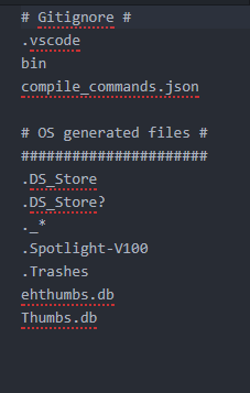

As for when you are building your project, try adding compile_commands.json to your .gitignore, deleting that json file and then recreating it by running prosv5 make clean all. When we were pushing from multiple computers and then fetching that file from a different computer, it would mess up our compile.
oh ok thanks i will try that @815J
i still get this error
and this is how i added it to gitignore
Then instead of that, try running prosv5 build-compile-commands inside your project directory and try compiling again.
delete compile_commands.json
make clean
