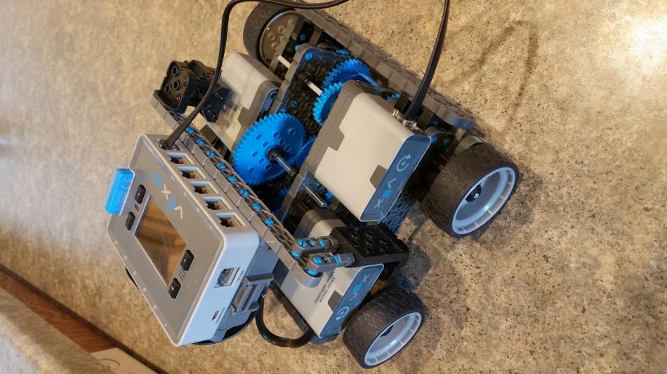

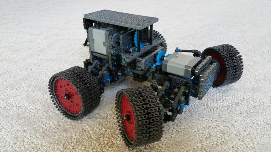

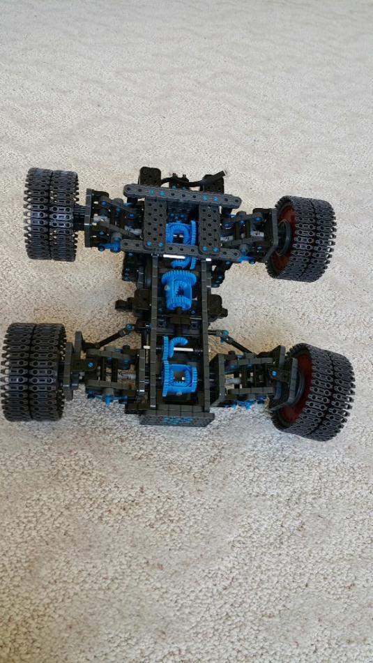

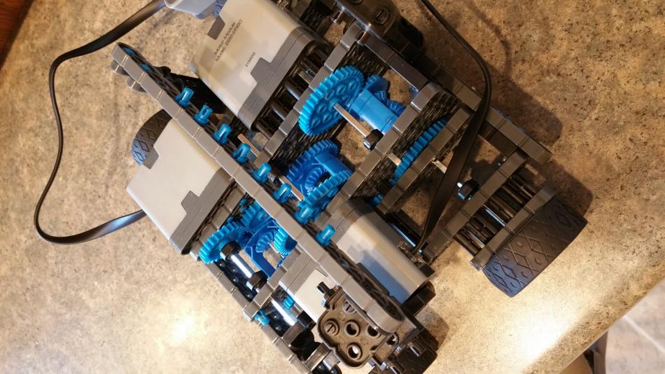

Attached (first 3 photos) are pics of another application that I built. Three motors and three differentials were used. Each motor turned its corresponding differential at a different speed. (2:1, 1:1, and 1:2) The power was transferred through all three by the small 12-tooth gears linking the entire system to create a kind of transmission. Only two wheels (opposite / diagonal) are actually powered, but the differentials allowed that power to “shift” between wheels as needed.
By powering each motor seperately, I got three speeds. When multiple motors were powered in combination, forward and reverse, I got the torque of multiple motors and even more speeds. Slow and powerful, to very fast!
The last photos are of a more traditional AWD vehicle similar to Apalrd’s. Not very fast, but it does use diffetentials.
