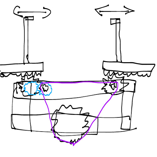

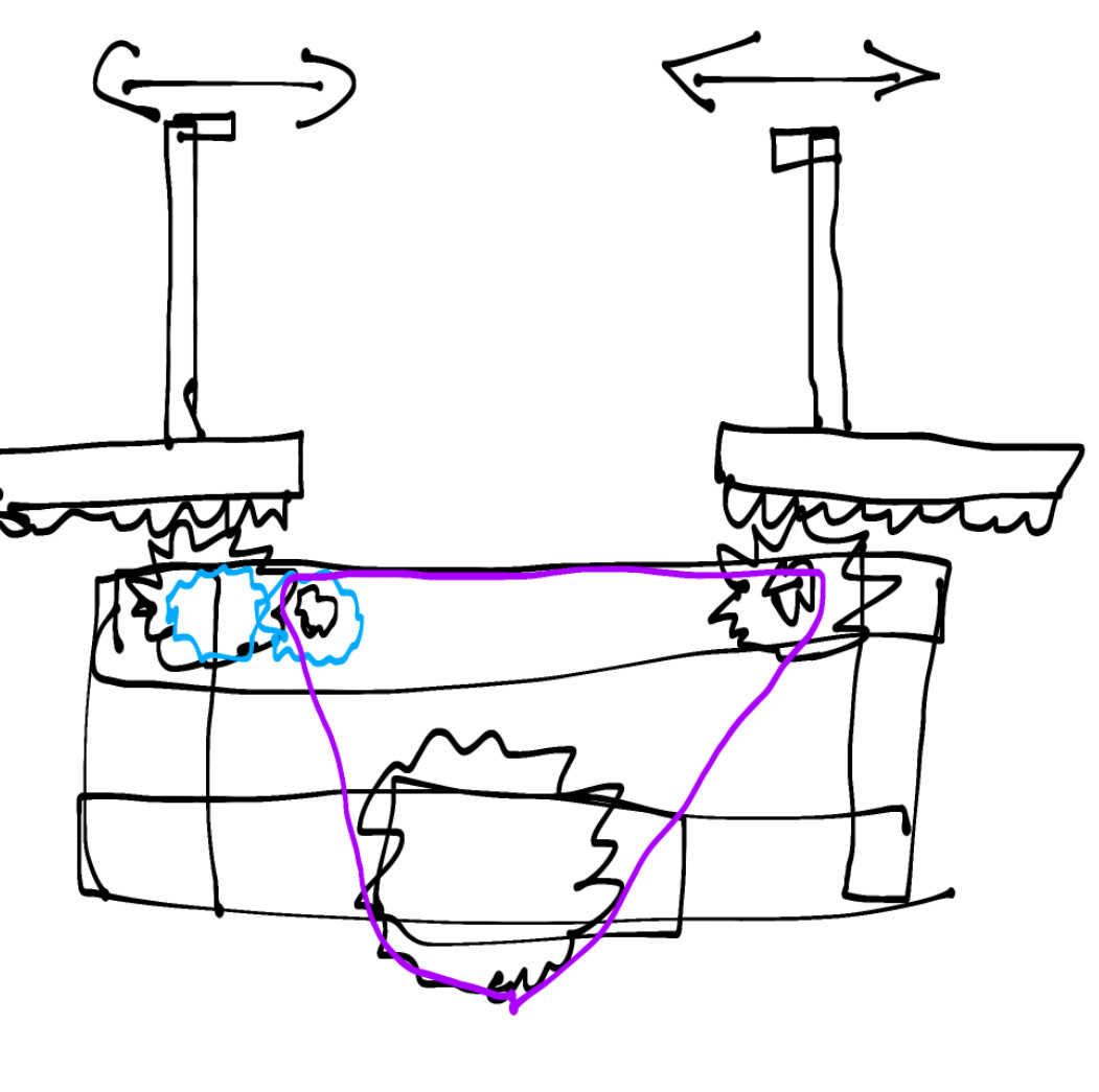

Instead of a claw, an efficient version of this: (I call it a byte mech)
It can grab both a pin and a beam. If you add the pneumatic 180 flipping thingi you could make 3m H drive with a 2m lifting mech and a 1m byte mech.

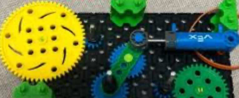

Diffy is honestly goated if you make sure you have the space and parts. It has the least amount of friction, and has incredibly fast switching. The only problem with the diffy is that a poorly built diffy can break frequently, and many people don’t have sufficient parts to build a diffy.
