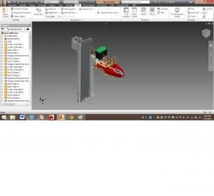

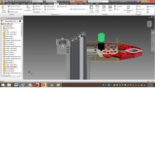

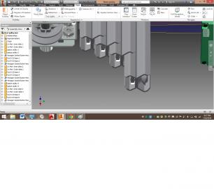

I am from a team that was recently begun. I have designed a slaved pulley for the skyrise game and need to get some discontinued parts. In partucular I would like to know if anyone would be willing to sell me any Linear Slide (2-pack)
(P/N: 276-1096). I would like these because I find the new slides to be too difficult (and poor fitting) that I worry for the lift. I would be willing to buy up to 3 packs (6 total slide sets inner and outer members) but only need 5. I would also be willing to buy one set at a time if that is all that can be managed. Thank you for your help. :slight_smile:

I see that that is possible but it is much heavier than my design. I also want more structural support. I will include a copy of the cad to show what it is I am doing.

I am new to this and must apologize. I have used pack and go and zipped the file (7-zip). The file is 19mb+. what should I do?
Can’t believe I didn’t think of that. Thanks.
Pics are a bit small.
How is the lift driven? I see lots of slides but no real way to make them extend.
I have a winch in a different cad that winds a string that enters at the back with the vex pulley (not my custom ones on the slides but the one that is perpendicular to the slides).
This series of pictures shows a good way to create a similar effect with the new slides
Use the plastic guides in pairs. For each stage, you will have one bolted to the top of slide 1 and free-sliding on slide 2, and one bolted to the bottom of slide 2 and free sliding on slide 1. Doesn’t matter which you use the outer or inner for. This works better than a single fixed slide, because it maximizes a characteristic called bearing ratio, or the effective length of linear contact between slides at any given time. This reduces binding and helps the elevator lift more smoothly.
That lift actually has no drive mechanism (pulley). when you add pulleys, the spacing changes drastically (I have a plan B). And that is why I prefer the old slides.
