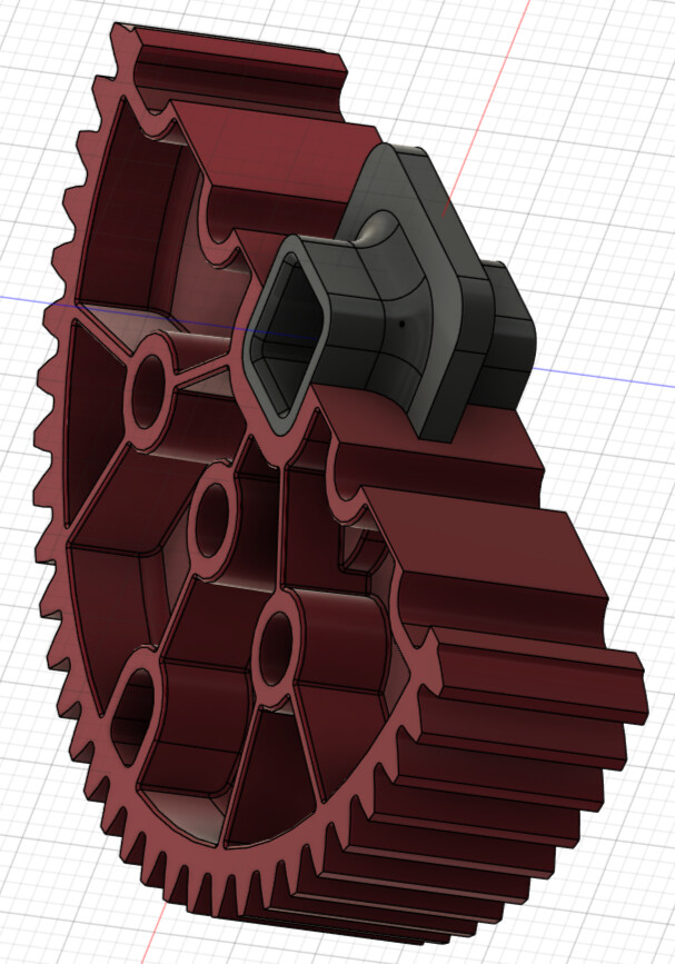

Small gripe on the ‘new’ gears. The inserts are not inset… making the gear width about 1/10" wider. Other than mfg ease, I can’t see a benefit.
They’re much stronger overall, and the new hole layouts are helpful. And this is not easier to manufacture. That’s an overmould, which involves a hefty investment in tooling.
