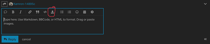

it wont let me send videos do you know how to
You cannot upload videos here, you have to use a website like YouTube.
