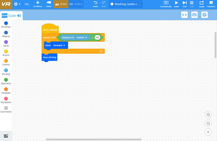

Not in retaliation, and I do know this does not prove my post was helpful, how does this image
help them in any way? You think the problem is with the waitUntil block? Then why would the waitUntil block work when he uses >? But you didn’t explain why this would work or anything, you just gave him free code to copy, without learning anything.
If he doesn’t, I’ll be happy to rewrite it in block-er code, but I think at least reading and translating code to blocks would help him understand the code he’s using. I don’t want to give him ready-made code to mindlessly copy, since
