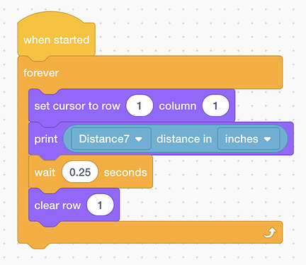

We have several kits with distance sensors and they all are having this issue:
The distance sensor displays correct values when run directly from the brain via Settings→Device Info→[port] (and reports “No object beyond” 19 inches) but when run from a program in VEXcode IQ Blocks, it fails beyond about 9 inches and displays “1” (1 inch).
Can you post your program that you’re using? I just tried it with the following and everything seemed to work OK.
22%20PM
IMG_4540
I hadn’t included a wait block. With the addition of that, it works correctly (displaying 4294967295 when beyond about 20 inches).
Do you have any idea why the wait block would make a difference?
Possibly clearing the display quicker than it can write to it so you never see the full number. The wait gives it time to render the display.
Printing / clearing too quickly. The wait block allows time for the text to be drawn on the screen (and read by the user). Typically a 1/10th of a second is more than enough of a delay when printing on the screen.
The “4294967295” is a maximum unsigned 32-bit integer. This is because the sensor reports “-1” when an object isn’t detected. We felt that -1 wasn’t help since a lot of times logic is checking “distance sensor < X”, so instead the value was made positive. I’m not sure (2^32)-1 is the best choice, but it’s better than -1… but that’s a separate discussion.
Thanks for the explanation! 2^32-1 is just fine by me… it allows for anything reasonable larger than zero to be used as a value.
