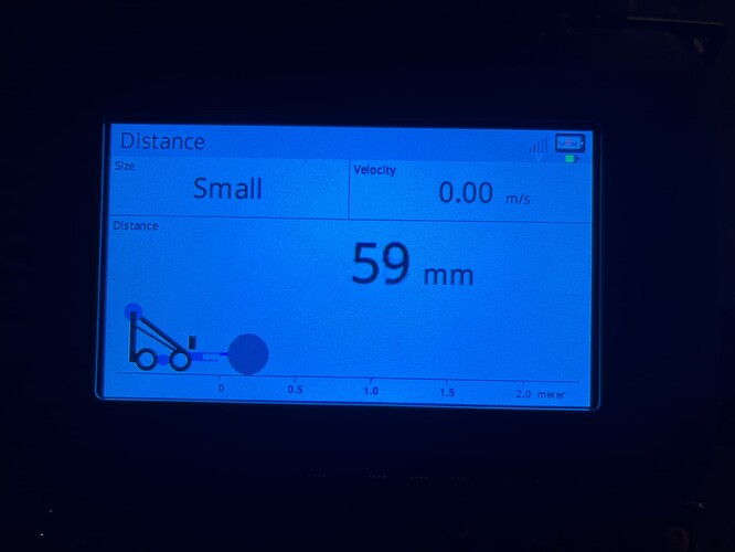

I can’t exactly remember, but you should be able to view the distance sensor output in the sensor menu on the V5 robot - if this is displaying a value then you’ll know it’s not the distance sensor which isn’t working.
Go to devices on brain menu:
(Mine are on 12 and 13)
Click on the icon and it will take you to this page, where you could potentially diagnose issues:
