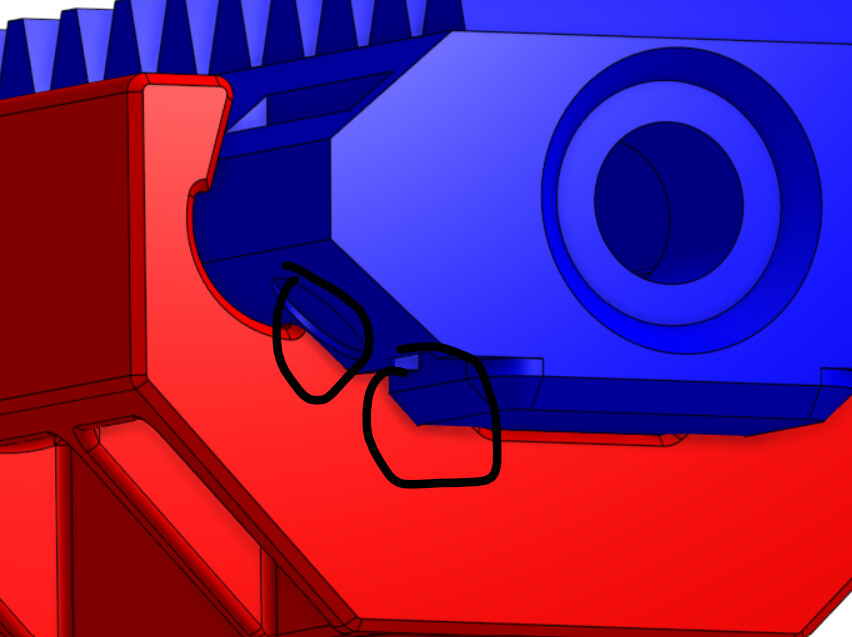

Thank you to @DRow for fixing the link, I got the CAD files…
But it doesn’t look good
The IQ rack gears seem to not fit with the V5 red sliders nor the metal channel. Sorry…
Thanks for all the extra work, I appreciate it. It was always a reach.
