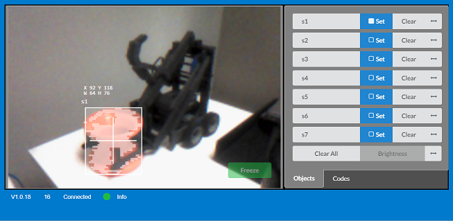

Do you know if there is any programming interface that could read object position on your computer, or all you get is a live stream?
Yep! When writing up how to configure the Vision Sensor in Robot Mesh Studio’s C++ for IQ, I took some screen captures of the configuration tool in use where you can see the object info:
As far as I know, this is (roughly) the same interface that all the programming tools use for Vision Sensor configuration.
