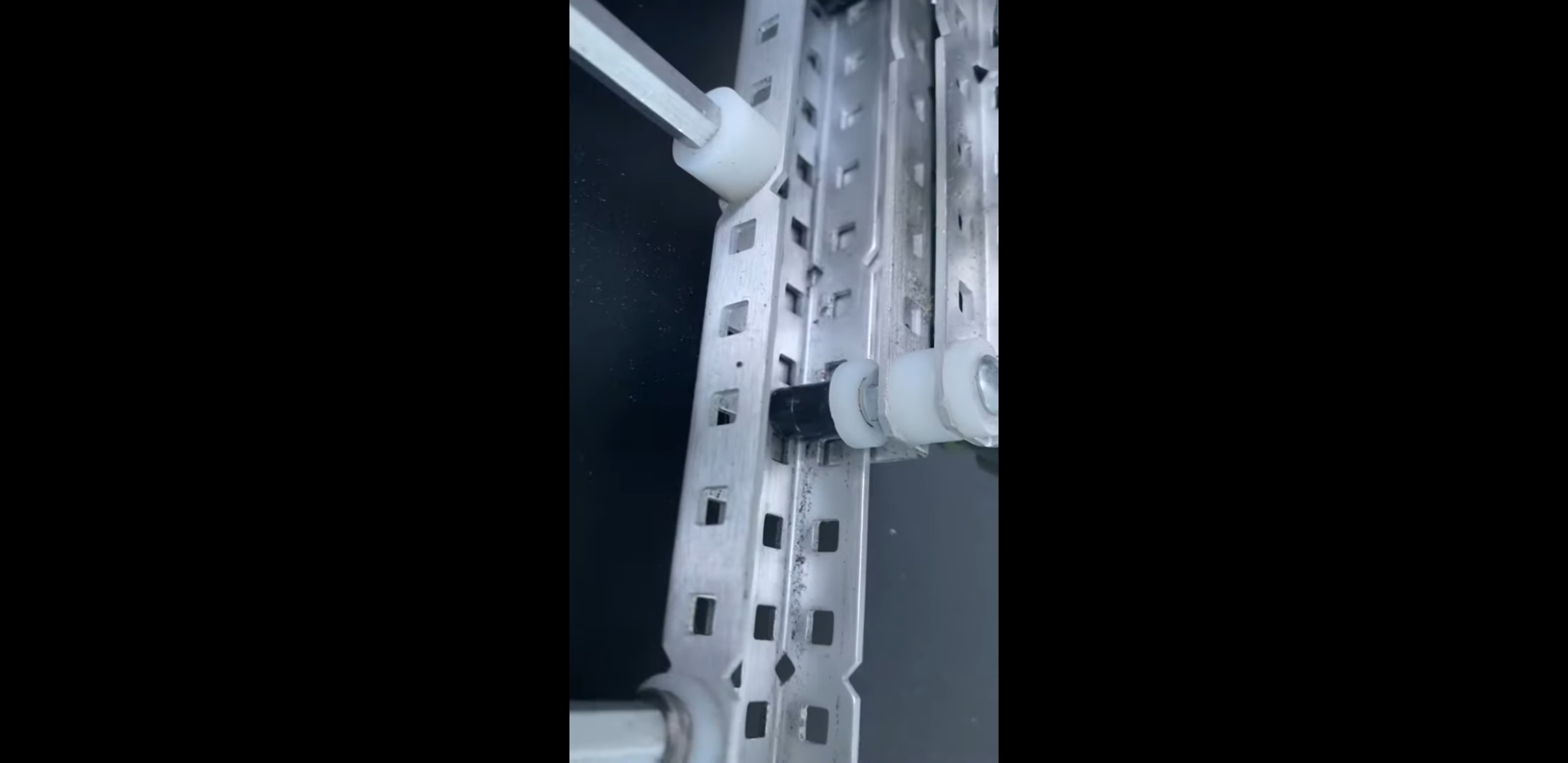

What about the ones that people made with c-channels and spacers? I’m not sure which spacers are the best for that and where to get them. Also the correct configuration (sideways/upright)
@Sylvie made a nice CAD of one in this video right here https://youtu.be/ofPnmvIjRkA
This is also a good one he made https://youtu.be/NtjCpnHct-w

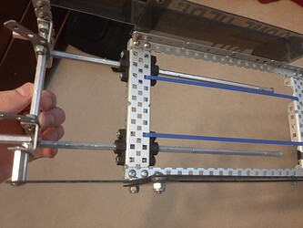

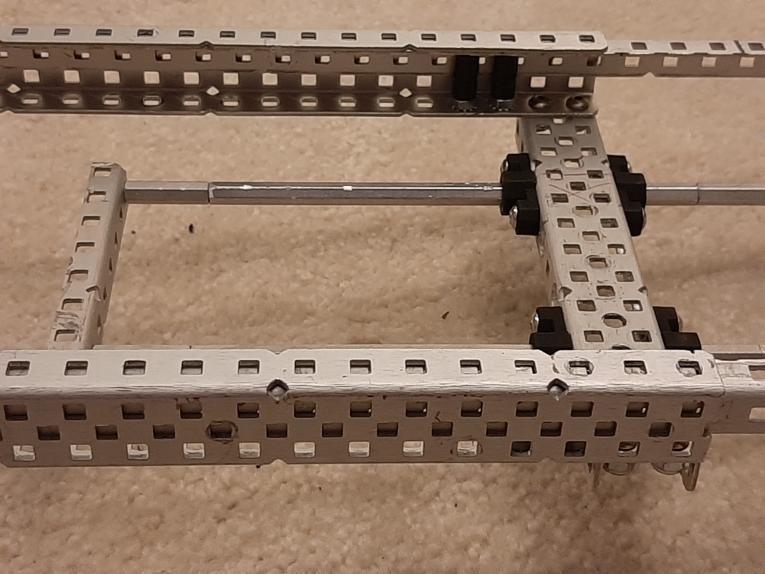

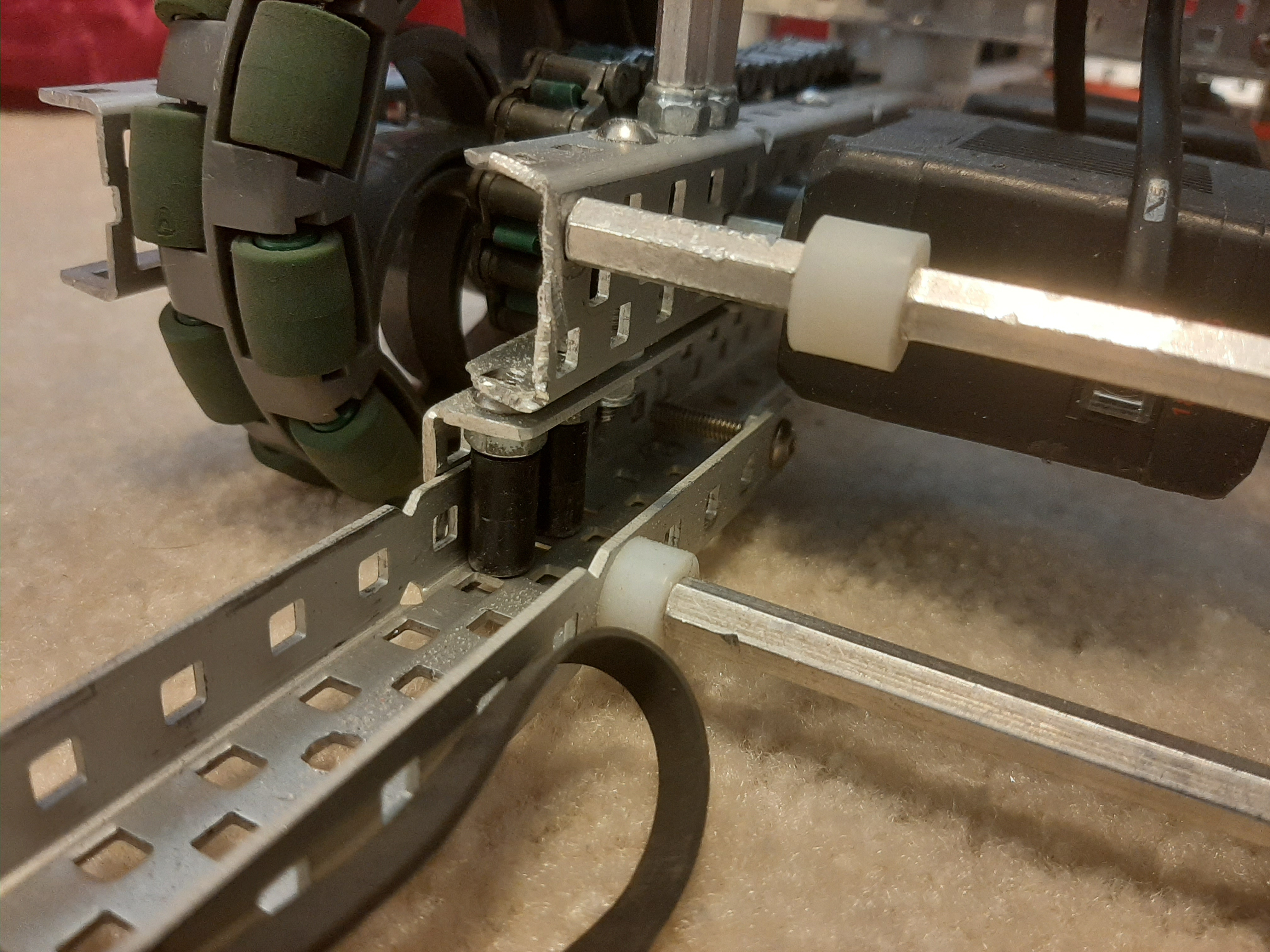

There are many different ways to make custom slides.
Standoffs fit nicely in high strength bearings, so those can be used to make many types of linear slides:
20200421_175037
Also, if you lock a .75 inch screw to the inside of a c-channel with a keps nut and put 8.1 mm plastic spacers on top, it leaves just enough room for a half c to fit making a good slider (although grease is highly recommended for these:
This can also be extended to full c-channels
Furthermore, you can use a slightly loose plate and a mix spacers to create a nice fit for a half c
20191125_171653
slide 2
These are just a few of the many ways to make custom sliders. Just follow the general principle of metal rolling on spacers, get creative, and you’ll be able to come up with something that suits your needs.

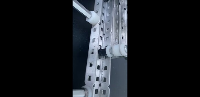

Hey I see I am late but look up on youtube 7700r’s robot explanation video he shows custom slides up close for antitips.
Screenshot_20200426-122431_YouTube
