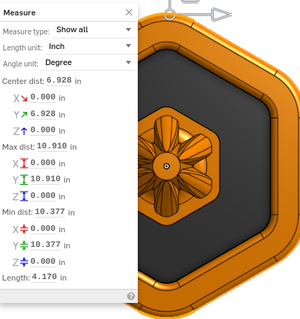

The mobile goal pvc has an outer diameter of 0.84 inches

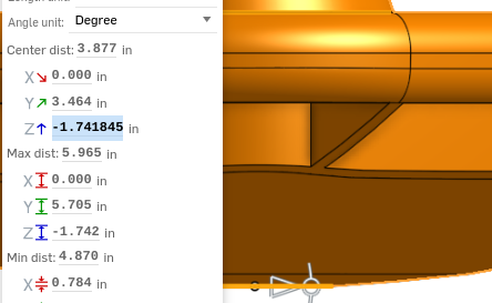

Some other measurements:
(Use the max distance for corner to corner)

As stated in the video, the mobile goal has a maximum diameter of 10 inches.
