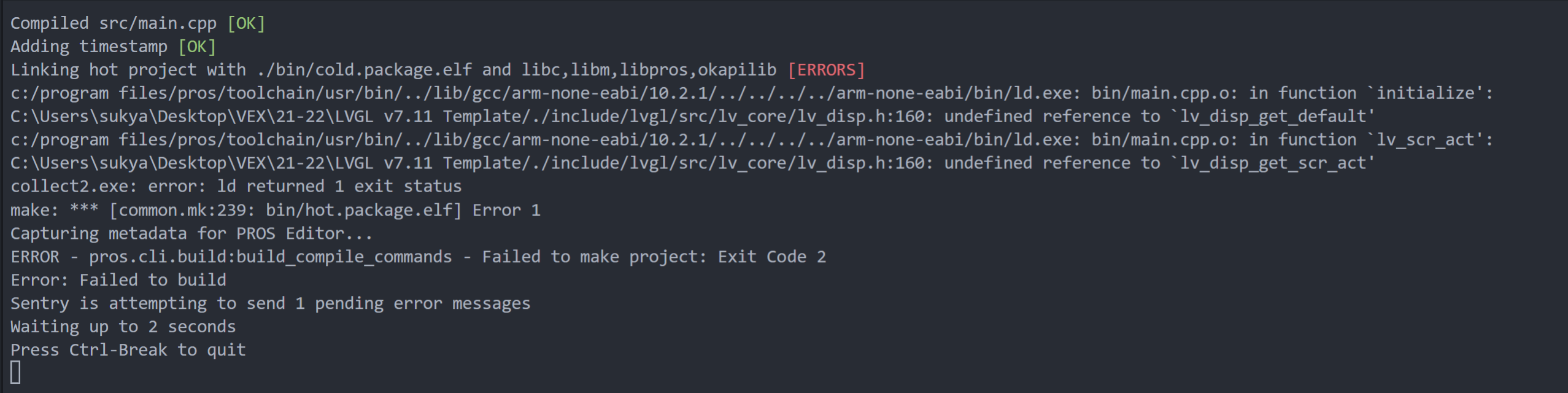

So I pasted the v7 LVGL library in and configured the .h files. However, I get a compiler error, probably because the path changed. How do I fix it?
