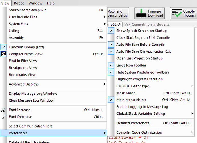

You should turn on the auto backup feature that @jpearman described:
Or, you can turn off the autosave, which he also described:
Note he says they’re turned on by default. Turn them off if you don’t want them. Here’s how those look in the UI:

Wow! Very nice of you to provide a screenshot. Thanks!
