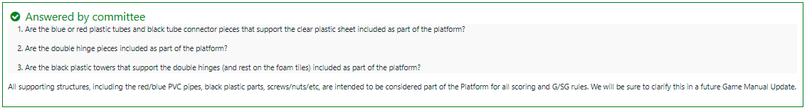

Does the platform includes the black supporting structure? Would a stray ring leaning on that structure prevent it from balancing
In the official Q&A, the platform is defined as follows in the screenshot

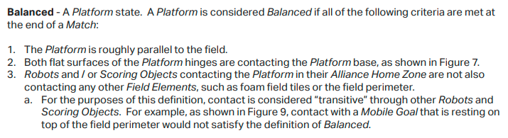

The definition of balanced is…
Since the platform is the entire structure, and any field elements or robots touching the structure cannot touch the field tiles or perimeter, or transitively touch them, would anything leaning up against the black tower stop the platform from meeting the definition of balanced?
It’s probably an obvious answer that I’m missing, but I’d rather clarify it and be certain.
Hopefully G3 (common sense) prevents this, but I think it is worth another q and a.

I think the notion that a ring touching the base of a perfectly balanced platform would cause it to no longer meet the definition of balanced would be dismissed simply by using common sense (g3). There will always be ambiguity in definitions like this, but it only becomes a problem when common sense cannot clearly and obviously determine what the correct interpretation is, such as the former issues with autonomous scoring.
I’m not sure, but I think they mean only the things from question 1 are part of the platform. They don’t specify the double hinge or the base in their answer, but do specify the colored PVC pipe and the black supports. This also lines up with the current platform definition where the entire platform is off the ground.
The answer’s wording is a bit vague though so the “black plastic parts” could also include the hinge and base which just loops back to your question.
They also said that they’d update the definition in a future manual update. I hope that’ll help
