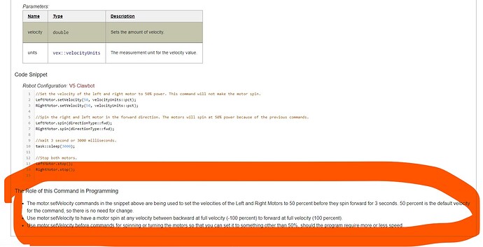

It returns the current velocity in percentage so -100 to 100, no matter what the target velocity is. Also there is documentation here.
