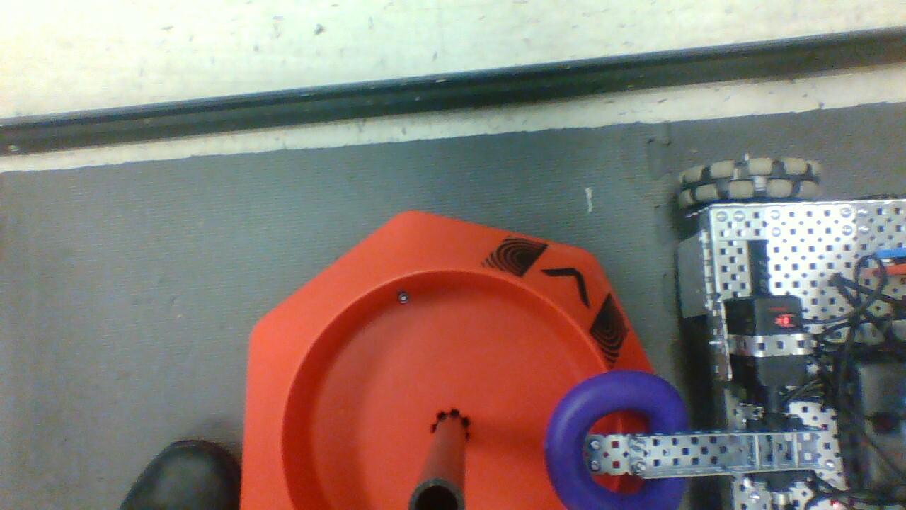

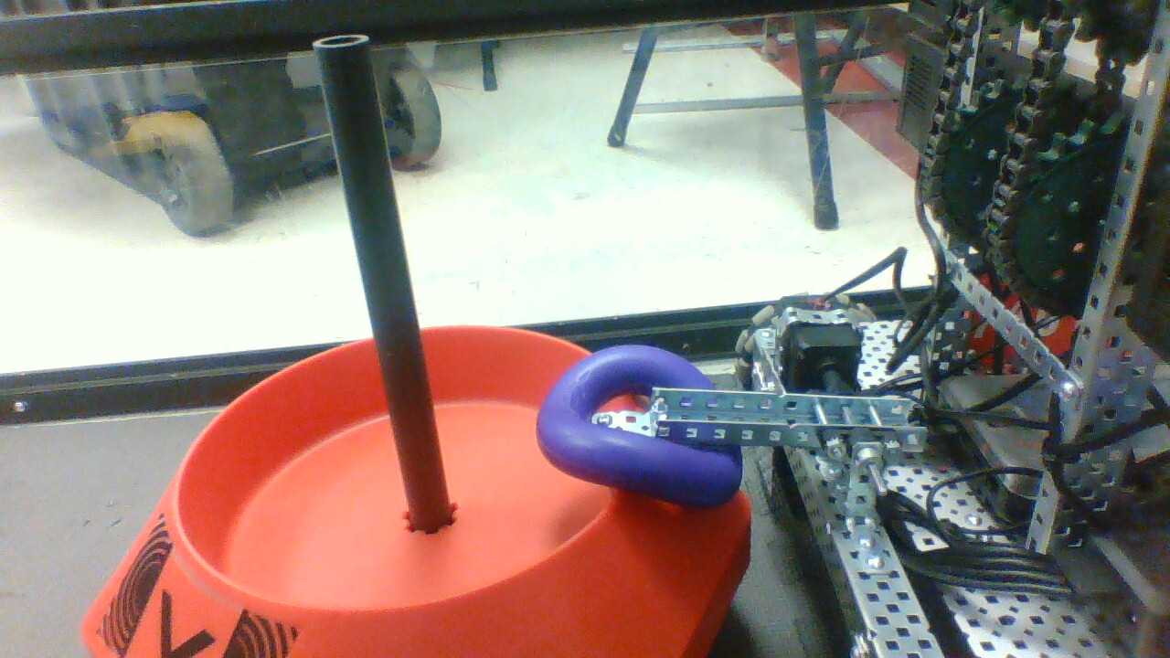

my sister team made a AWP auton and it puts a ring into a goal via tailbar. the only thing is is that it only goes in halfway, does it count?
I don’t think so off of the top of my head? The robot is still touching the ring.
if you can find if it offically does that would be great
Take a read of scoring note 1, and scoring note 2a in the game manual, then reply back to this thread with your interpretation, including a comment on whether the robot is touching the ring or not. After that we can discuss.
Not sure the criteria for how far a ring is in the goal but if the ring it touching the robot which it does appear to be so then it is not scored

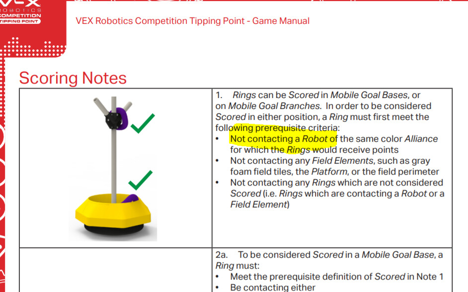

2a. To be considered Scored in a Mobile Goal Base, a
Ring must:
• Meet the prerequisite definition of Scored in Note 1
• Be contacting either
॰ The colored portion of a Mobile Goal Base, or
॰ Another Ring which is considered Scored in a
Mobile Goal Base
2b. To be considered Scored on a Mobile Goal Branch,
a Ring must:
• Also be “encircling” a Mobile Goal Branch
• In this context, “encircling” means that any part of
the Mobile Goal Branch is at least partially within the
volume defined by the outer edges of the Ring
it does say anything about the robot touching it
