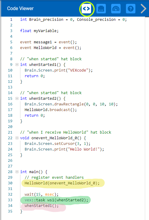

Does V5 Blocks have multithreading?
I am a TA in a robotics class at my school, the majority of the class uses V5 blocks and I am interested in how the “when started” block works. When you have multiple of them does it split them off into separate threads/tasks or does the code still remain linear? I also have the same question about the custom blocks and the “broadcast message” and “when message received” blocks. My assumption is the “when started” blocks are their own threads along with the “broadcast” and “receive” blocks while the custom blocks are linear. I am just guessing though as I don’t have much experience with V5 blocks and have never actually tested it, if I am wrong about the way they work it would be great to know so I can help people with their problems better!
I used VEXCode blocks to create two When Started events and a custom HelloWorld event.
If you click on the Code Viewer (<>) button it shows the following image. There are three methods. HelloWorld is an event, the second WhenStarted is in a separate thread (task), and the first WhenStarted is in the main thread. Both threads can call (broadcast) the HelloWorld event.

It was more of a question for me, the students are doing it without understanding what multithreading is. I just want to make sure that’s actually what adding multiple when started blocks is doing. Right now it is a very big leap from blocks to c++ or python for them. I think it would be great if they could but it’s pretty early on for them to do that.
Ah okay so adding multiple when started blocks does break off into multiple threads along with the broadcast block when called. Presumably the custom blocks are just a way to neaten up code and still remain linear correct?
