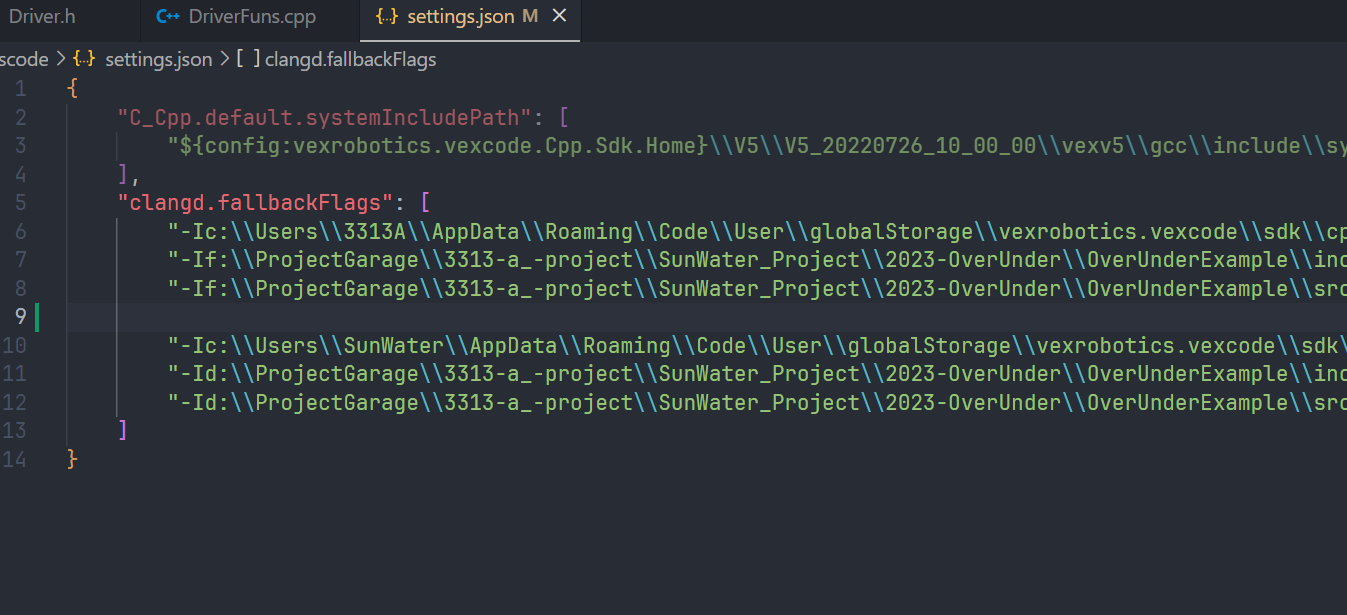

However, since VEX dosen’t originly support clangd, I need to do some configuration.For example, write the SDK Path in the setting.json.
And I actully need to download another standard c++ library, because it will report errors when I use the origin standard c++ library included in the VEX SDK.

The extension let’s you use whatever language server you want to. If you want to use clangd then go for it but, as you have found, configuration is left to the end user.
Also, standard C++ library is part of vexos, be careful trying to change how the extension builds a project.
I mean is there any chance that vex extendsion can help me to do the configure or genurate the complie_commands.json like VEXCodePro?
