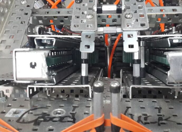

I already posted this on FB VEX group but I’m gonna post it here too :slight_smile:
“This is really exciting cuz my friend who is in Ürümqi, China (Team 8468) send me this video about their well functioning double puncher!!!
The way they did it is absolutely amazing and I’m just in love with their bot right now!”
Attaching file is a detail pic and even with that I can’t figure out how they did it :stuck_out_tongue_winking_eye:
Any ideas?
Wow, that design actually worked quite well :stuck_out_tongue:
Dual everything ftw :stuck_out_tongue:
Very interested to know how fast and accurate it can go…
Nice Design!
I was thinking the same thing!
