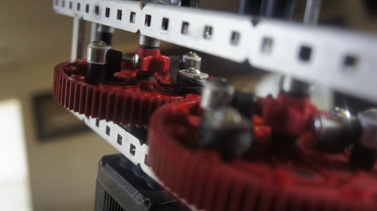

So we had a double flywheel, but we are currently doing a rebuild. That is a photo of how the gears looked. We originally had a single flywheel, but we found that it added too much spin, to the point of discs going in, then spinning right out. The double flywheel was also able to do better overfill.
What I did was put 2 36t gears in the middle which made sure both wheels were going at the same speed.

24T gears would be more compact and less cursed

Thats super cursed
Especially since you couldve just placed one in the middle

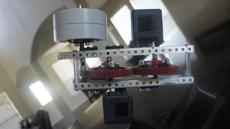

This was our prototype from a few months ago. We connected the motors directly to gears, put the flywheel on a 12T gear, and spun the motors in opposite directions. Do note that you shouldn’t cantilever your flywheel like in the picture, especially if you’re using low strength shafts. We only did that for testing.
You do relize that you need the 2 wheels to be moving in opposite directions… or else they will spin the same way…
Ye, but we don’t have them lol
Still better ways to do it
You can change that in your code.
Wdym? Both have to be spinning in different directions, because there are 2 flywheels spinning. If they was only 1 gear then it would be a odd number, so the gears would be going against each other. I understand that there are better ways to do it, but this worked pretty well for us and made sure both flywheels spins at the same speed.
