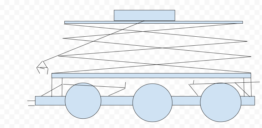

So I was thinking about how some skills bots are able to score two mobile goals at a time and I thought: what if you were to toss a lift on that design and stack cones and two mobile goals? Anyways, I call it the double internal stacker, and here’s what I’ve come up with:
If my team lets me build a prototype, it would include an 8 motor drive paired with two mobile goal intakes. It would also feature a two motor DR4B or scissorlift that would have a chain bar attached to it in order to be able to pick up and stack cones on both sides of the bot and thus both mobile goals. Anyways, thought it was an interesting design idea and wanted to share it.
Will you have space for 2 mobile goals and a lift and still remain within the legal limits? I think it’d be best to make a CAD model first - we always find that this saves lots of time in the long run
The lift is the sketchiest part right now because it would have to have not a lot of support so it wouldn’t interfere with the stack. If my team stops freaking out about minor problems and lets me start building, I should be able to get it to work.

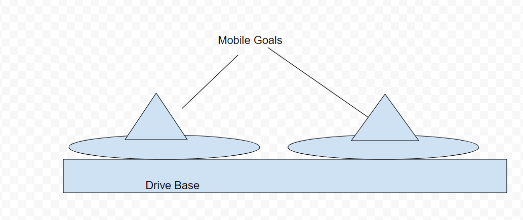

I was thinking I would carry the mobile goals similar to the way 8800X carries them. Heres a drawing; not exactly to scale but you get the idea:
So the pictures aren’t loading on my computer (school wifi). So are the mobile goals collected on opposite sides of the robot? If so, then my idea wouldn’t work. I was thinking you’d have them both on the back, is that right?
No, they’re on the opposite sides. My idea to defy SG9 would have them on the back, though.
Oh ok. So my idea wouldn’t work then. But one thing you could do is put a pretty large chain bar in the center of the mogos. Make it so it can get cones from either side of the robot. Then, just pick them up and since its long enough to reach over the mogos, it won’t be able to set the cones down on them, but you could just drop them on the mogos. I’m thinking rollers may be good for this idea, since they’re good at dropping cones precisely.
@briancole, I still think carrying two MoGos for 2v2 would make your robot less maneuverable and wouldn’t give much gameplay advantage, unlike all the benefits for skills.
Also, getting turntable for dual MoGo stacking to work both fast and reliable is challenging. You would need to make it very well balanced around the center of rotation, which may conflict with the requirement to have enough horizontal reach. But you certainly have to try - you may be able to figure out a very good way to do it.
For better stability, instead of relying on a single VEX turntable, you may want to try either a pair (one stacked few inches above the other) or have your lift rotate around the high strength shaft with two support points several inches apart.
