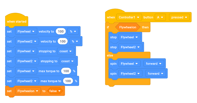

I just whipped up some single button toggle on/off code for you:
Double Flywheel Toggle code.v5blocks (6.0 KB)
Feel free to use it

Shouldn’t the ‘else’ block have a “set flywheelon = true” in there? Looks like the code, as is is posted, will either 1) only spin while the button is held down or 2) fail to stop after it’s manually started the first time.
I know the OP question is answered… need a ‘coast’ statement. But the code seems wrong…
Looks like it, not rlly good at this kinda thing
Oh yeah looks like i forgot that thanks
Here’s the fixed version:
togglecodefixedsorryitwaswrong.v5blocks (5.7 KB)

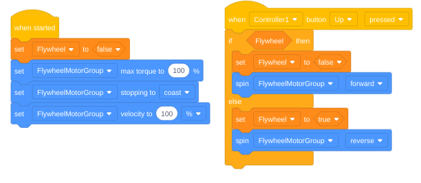

So it reverses spin direction each time you press the button?
:slight_smile:
That’s what I get for not checking my code, can’t believe it happened twice though wow
togglecode_versionwhateveritisnow.v5blocks (5.7 KB)
