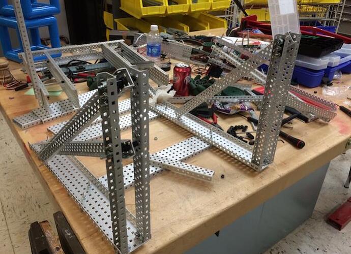

This is all I had got done today, does the amount of gap in the middle even matter?
The gap between the arms? You want the arms to be a whole number of holes apart for cross bracing and easy intake attachment, although I wouldn’t call it strictly necessary. I would also recommend you use a screw with a locknut instead of an axle to minimize the amount the arm can wiggle.
I think I will try a 5:1 first with 6 motors on the lift, and if that doesn’t work do a 7:1.
I will add bolts tomorrow when I get time hopefully.
