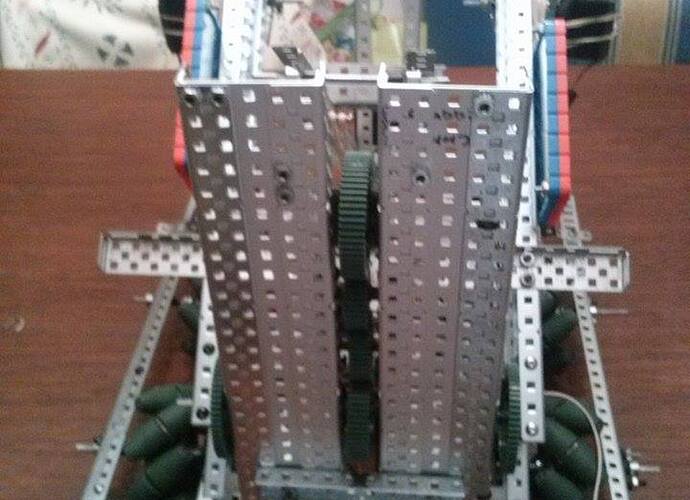

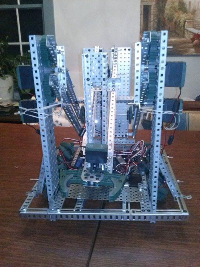

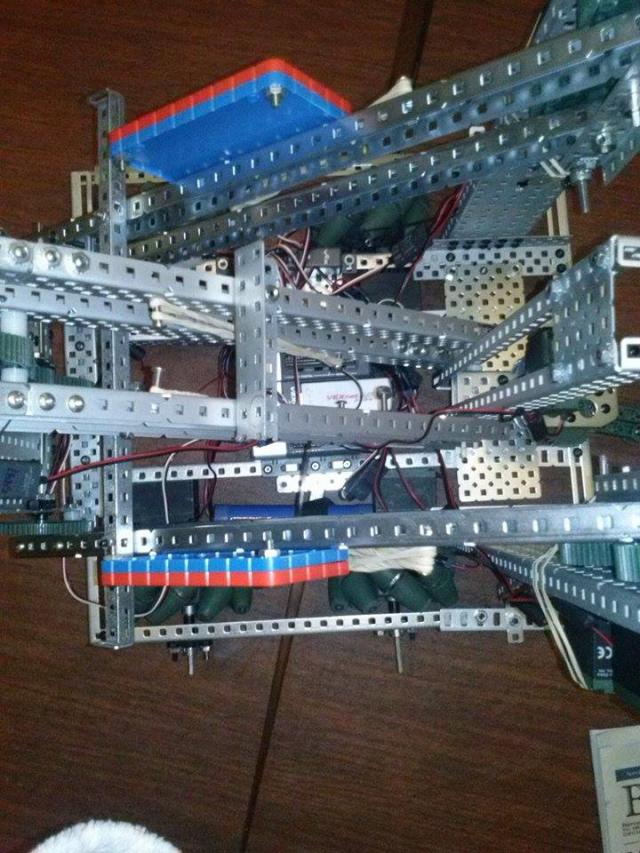

Long story short my team has Regionals tomorrow, our robot doesn’t work, and we don’t know why. We don’t think it has anything to do with the programming or the weight, but we aren’t so sure about that (though we did use a lot of Aluminum). Attached are a few pictures of our robot. We are planning on tomorrow (at Regionals) switching the gears in the front (for the bottom layer) from three medium sized gears (high strength) to big little (with the motor in it) big. If anyone has any idea what else we could do to possibly make this robot work, or as to why it doesn’t, we would be hugely appreciative. Also, the claw will be going on the two (on each side so four) aluminum bars in the middle of the bot. Thank you.

What doesn’t work? Does it drive?
Sorry. The wheels are fine but the lift doesn’t work unless you do it manually.
Does it try to lift?
You need more rubber bands.
Check that each motor is moving.
Check that each motor is turning the correct direction.
(also, not related but check your dimensions, it looks very close to 18", check the axles are not too long on the drive).
yea axles reach about 17.5 and we have to shave the top off of the highest point of the robot (like 18.2) we tried adding more rubber bands but it just lifted the lift up and held it there and we had to use the motors to get it back down. Also all motors have been checked (one burned out - had to be replaced) and are going in the same direction.
Your lift does not appear to have a gear reduction between the motor and the lift gears, at all.
A vast majority of teams use a 7:1, with the fastest I’ve ever seen being a 5:1, maybe. You are essentially running 1:1. Those motors don’t have any where near enough power to run that kind of ratio, and if they did, the lift would go up in around a third of a second to full height.
I would highly suggest looking at some other successful double-reverse four bars and definitely add a much larger gear reduction. You should also look into supporting your shafts on both sides as cantilevered gearboxes can be prone to skipping.
With such a small time-frame, the best solution would be to either try and use the Vex turntables as you can get a decent reduction out of them and not have to make a custom gearbox, or playing to your strengths and moving some motors to the drive train to be stronger at pushing.

Originally it was entirely a strength issue. Is it able to lift now? What is the ratio?
In terms of leaning the best way to fix that is cross support across the lift. Several teams have had success with small X’s across the lift using 1 bar. These are light and cheap so if you have a few you can try that. Also just standard cross supports will help as well. Also connecting the axles together on the middle tower should help bind the lifts together ensuring less lean.

X’s connecting the 2 sides of the upper arm. It binds the left and right side of the lift together well.

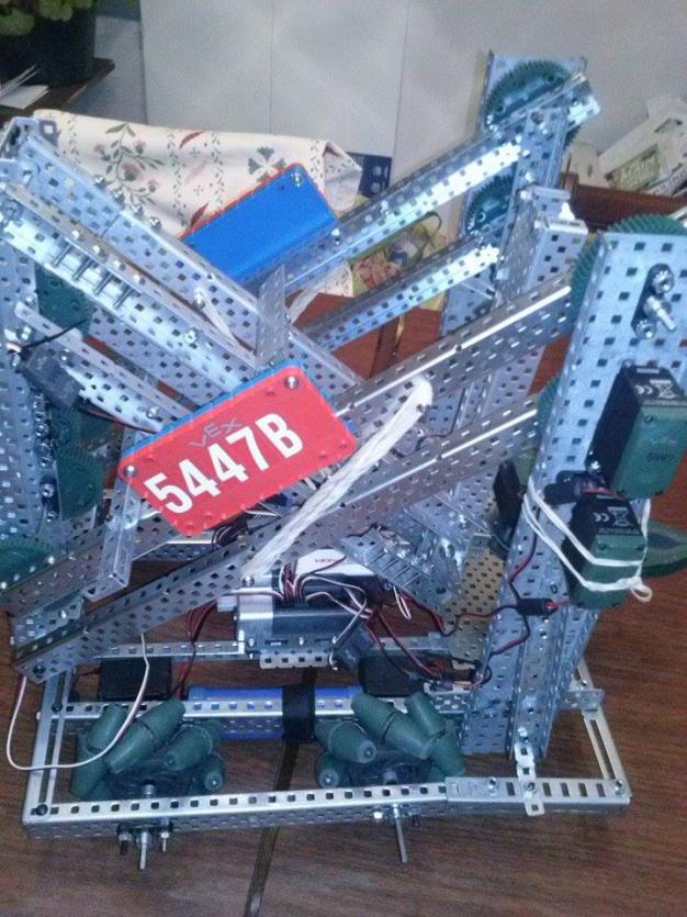

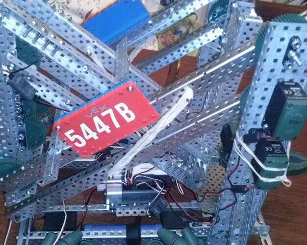

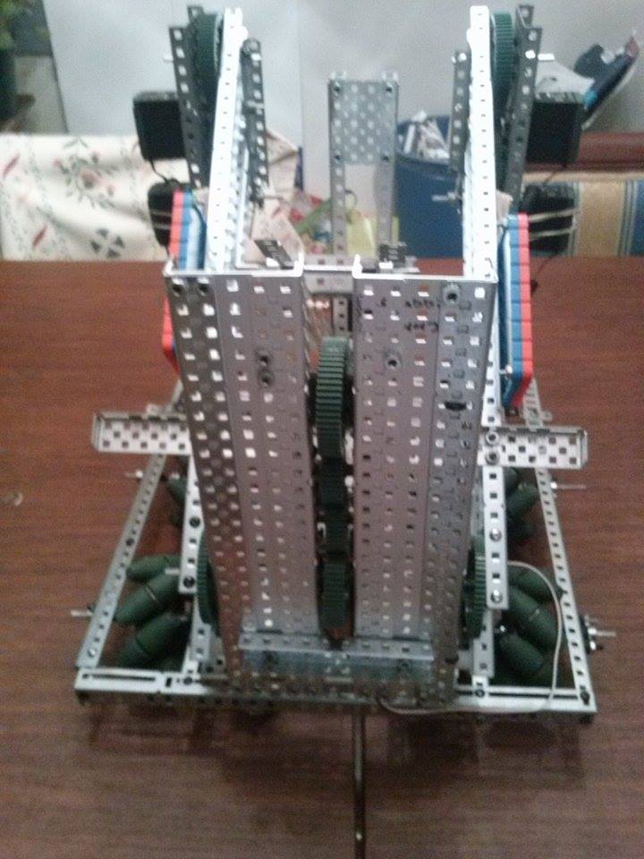

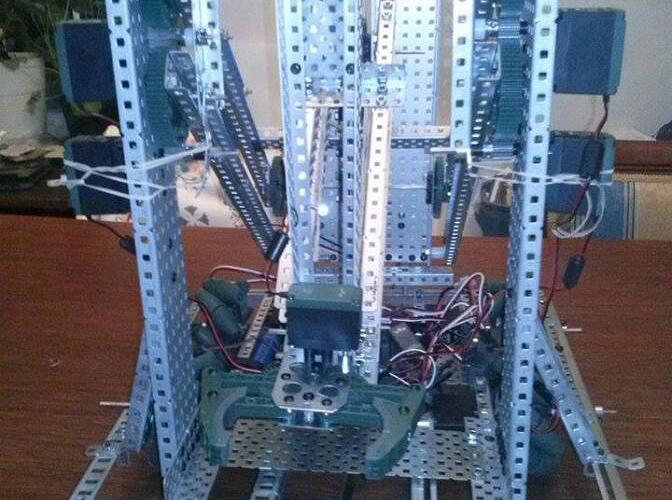

I discovered that I can message myself pictures from fb and I went from there. Here are several pics of the current bot. I have like two or three more pics but I guess there is a 5 pic limit. Thanks again ~Zoe

Since these pictures were taken, the lift has been stabilized well, though it did add on weight :(. Therefore, the lift can barely get to half of its potential height. Before, it could reach maybe half to two thirds potential height. It also angles and occasionally leans/ tilts hardcore to one side for no distinguishable reason. If anyone has any idea of how to fix this or about what is wrong it would be greatly appreciated,as we had hoped to to use this robot for Nationals in addition to the second half of Regionals tomorrow ( well technically today). Thanks for the help.

one thing I noticed is you have cantilevered lift arms. Although you have an inner bar to tie the axles together (which is good), this bar seems to be missing bearing blocks. I would suggest you extend the inner bars and secure them to the lift towers with beams to improve the arm stability. With the addition of bearing blocks and non cantilevered arms, friction will be reduced on the lift drive shafts. Also, have you tried using more rubber bands? Are all your lift motors geared for torque (ie 100 rpm)?
