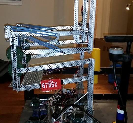

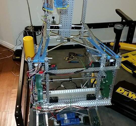

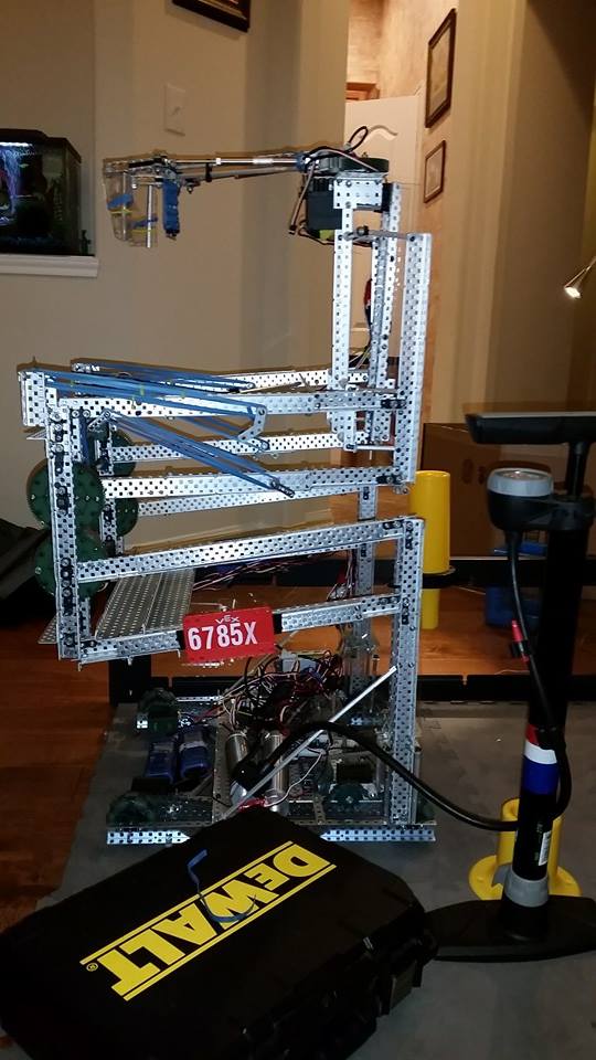

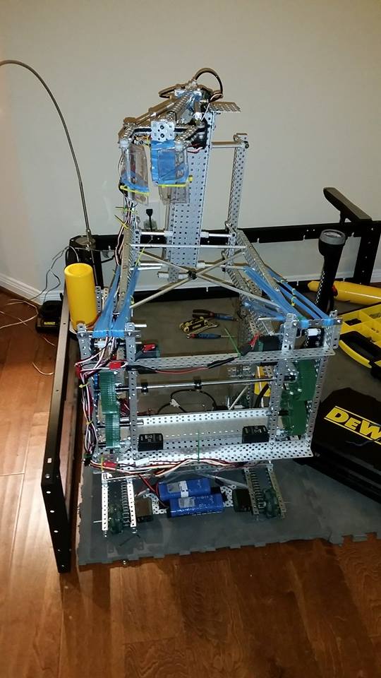

I currently have a quite successful double reverse four bar (we’re going to state in two days). However, I have placed all four of my lift motors on the middle vertical section. (motor placement in 1st attached picture) I have noticed that alot of double reverse four bar lifts that are able to lift 3 cubes have 2 motors on the middle section and 2 motors on the towers in the front of the robot. (motor placement in no longer attached picture) Is there anything to this theory? I can’t think of any reason why this would affect lifting capability, however it does seem to do so…

Well from my testing having only motors in the middle section causes more slop and in terms of lifting ability remember that you are lifting 2 motors other robots don’t.
Also most robots optimize their center tower to allow reaching to the same height as yours is able to without having as long arms.
You also lift twice as much weight in gearing because every gear is doubled up the metal gears add up fast.
I can’t tell dimensions from these photos, but perhaps arm length has something to do with the torque available. Maybe where the center of gravity of the cubes is maintained might affect what you can do with them???
The arms are 17.5" on upper and lower sides. (This pictures are a little bit outdated but the lift has not changed very much.) The cubes are held on a needle on the end/top of the lift.
Hard for me to see how your needle thing works. I presume the needle cube intake is at the end of an arm that swings out to the front of the robot during play??? If that’s the case, then I suppose your cube weight would be acting over a distance of not only the arm of your double reverse four bar but also the length of the needle’s arm. That extra needle arm length would induce a substantial torque on your motors in the middle/back of your double reverse four bar.
Torque = Force x (distance at which the force is acting)
In this case, the force would be the weight of the cubes acting at the total distance from the motors, plus the weight of the robot arms, motors, all the screws, etc. acting at whatever their respective individual distances are.
Contrast that to the other robot you pictured, which appears to keep its cubes closer to the center of the robot, so perhaps the torque for them isn’t so much.
